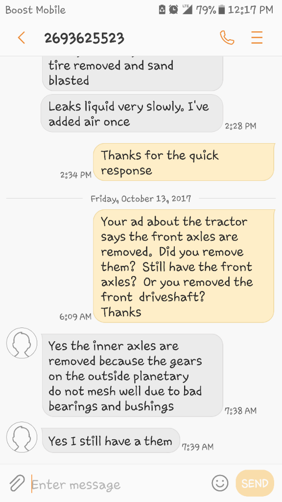

The tractor has a FEL . The seller said he removed the front axles.
Thanks for all the replies
Bucktownboy
   / 336d 4x4 not working #7
Bucktownboy
"removed the front axles..."
Yep, that will do it every time.
   / 336d 4x4 not working #9
Might be repairable at an economical price if gears are good.
