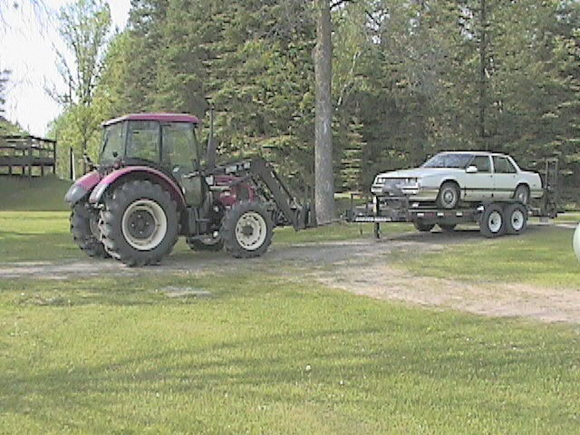

I agree the weight is levered if the pallet is chained in front of the bucket.
My tractor lifted this at about 1200 rpm easily on a ball out at the tip of 42" pallet forks. It is a 2K trailer + probably 3K old buick headed for the junkyard. I lifted it high enough to rotate on the rear trailer axle to minimize tire skid marks when turning on a concrete driveway.
Can you hear the pressure relief venting when you try lifting?
