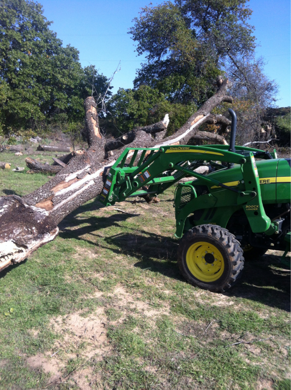

I have a 4105 for about 2 years now this tractor has done every thing I ask it to. As for load match I keep the revs up it doesn't stall the hydro gives up before engine.
Their is no electronic stuff on all cables and rods it does have electric PTO I think they all do now. The only real trouble I have had is neutral safety switch.
Here are some pics of it.
