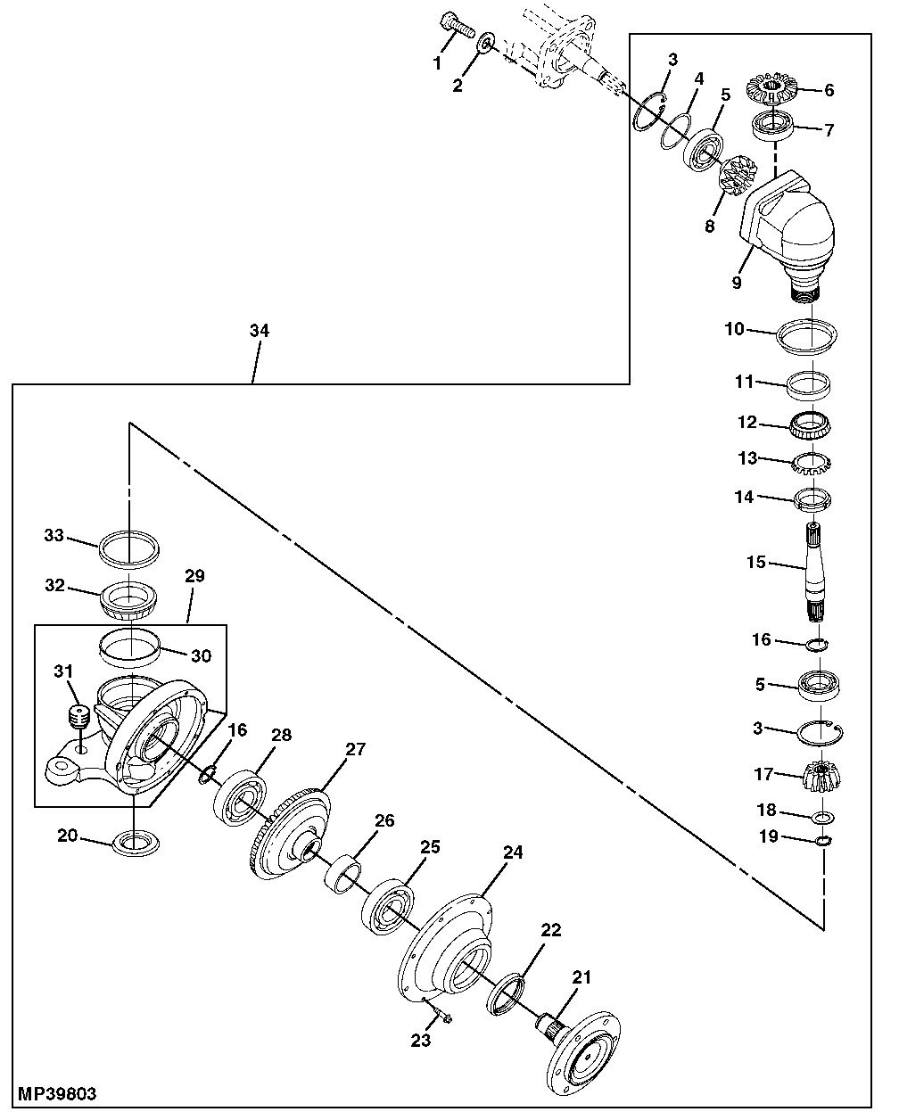

Can anyone describe how to change the front wheel seal on my 3320?
Wrapped a round bale twine around it. Caught it after only three revolutions, but it took out the seal. Too tight of space in that area. Poor design.
I'll pull the assembly off tomorrow. Guessing I'll need to press a bearing or gear off to replace the seal?
Thanks for looking!
/ 3320 front wheel seal replacement? #2
For seal #22...........
1. Drain the differential and the final drive housing being
serviced.
2. Raise and support the final drive being serviced.
3. Remove the wheel and tire from the final drive.
4. Remove eight cap screws. Separate the final drive cover
and hub shaft assembly from the final drive housing.
Note: The final drive cover is sealed to the final drive
housing. It may be necessary to pry the cover from the
housing using the two reliefs on the sides of the cover.
5. Remove the snap ring.
6. Press the hub shaft from the final drive cover,
bearings, and bevel gear.
7. Disassemble the remaining components from the final
drive cover assembly.
8. Clean and inspect all parts. Replace any unserviceable
components.
Installation:
1. Coat the outer surface of a new hub seal with John
Deere Sealant TY15130. Replace the hub seal.
2. Install the hub shaft through the seal and cover.
3. Place the ball bearing, spacer, bevel gear,
and ball bearing on the hub shaft. Secure with snap
ring.
4. Apply John Deere Sealant TY6304 to the mating
surface of the final drive cover. Install the final drive
cover to the final drive housing. Tighten the cap screws to
22 to 28 lb-ft
