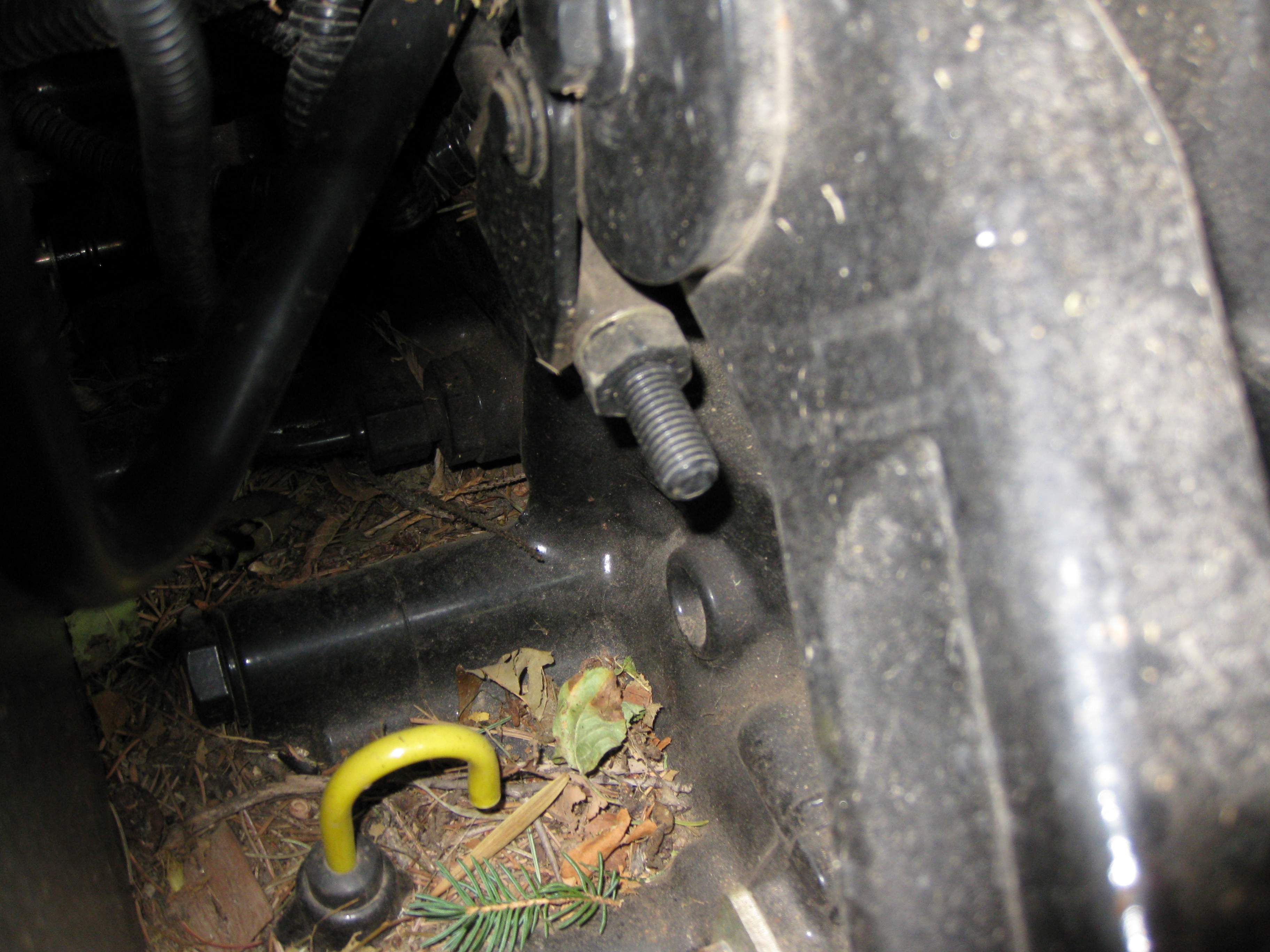

Hi Guys,
If I remember someone adjusted the lift of the 3PH to allow easy loading and unloading of BH's.
I'm concerned about breaking something, does anyone have the official procedure?
Thanks,
Rob
/ 3320 adjusting 3PH lift #2
Rob here is a pic of the adjuster and a post I made a few months ago. It's very easy.
Caledon Hills
New Member
Join Date: Sep 2009
Location: Caledon, Ontario Canada
Posts: 15 Re: Post Hole Digger Issues
I had a similar problem on a 3000 twenty. The lift arms would not lift the backhoe high enough to get the pins in. I adjusted the position linkage and in minutes the problem was solved. Attached to your left lift arm, when viewed from the rear, there should be a threaded adjuster with two jam nuts. Loosen one and tighten the other in very small increments each time lowering the rock shaft and carefully bringing it up to max to make sure the lift arms are not hitting anything. It has been awhile since I made the adjustment but I believe I turned the nuts clockwise to increase lift height. If not just go the other way and make sure both jam nuts are tight when you are done. A small increase in lift arm height will make a big difference to the height your PHD will go to.
Since this is a new machine the dealer would probably make the adjustment at no charge but because it is a quick fix I thought I'd post this.
Be careful and congrats on the new machine.
Regards,
Tom
