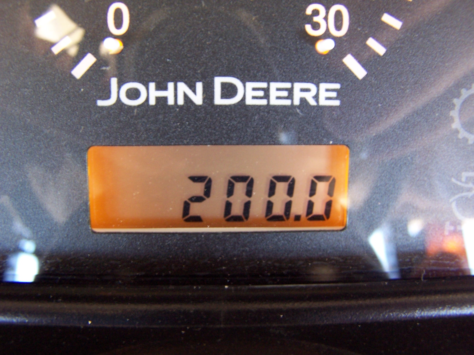

As stated, the tractor has 200 hours on it. It turned 200 hours on the 421st day of ownership. That's an average of about 2.1 hours per day.

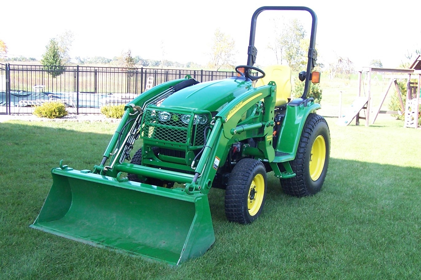

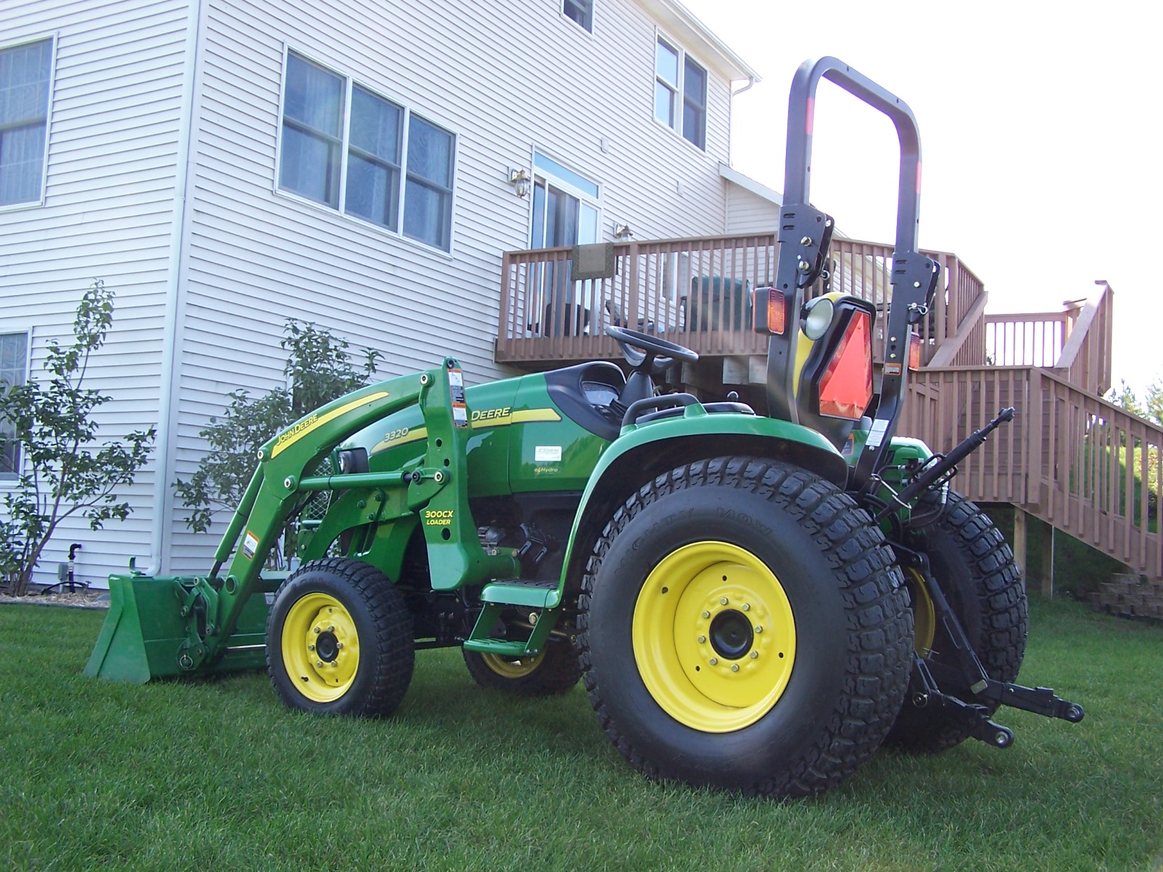

Fit and Finish: Typical JD. The cosmetics started out nice, and have stayed that way. See attached 200 hour photos.

In your pics it looks like your Turfs are in the narrow position. The Rears can be turned to wide for a bit more stability and still not interfere with the MMM deck, however, the Fronts will hit on hard turns if mounted wide.
