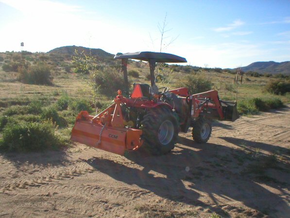

Joel, I use a 58" one that came from CCM. I have NO problems turning it and am sure that I could have gone wider. Might have been nice to have one 66" wide, but this one works good for me.
