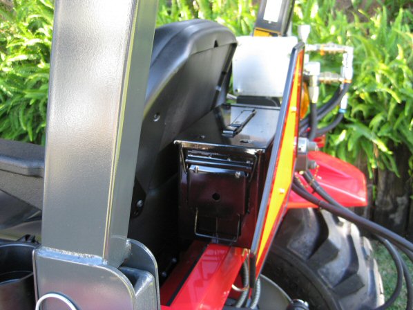

Thought that after about 10 months of owning my 3215 I would share the what I consider improvements that have been done to it.

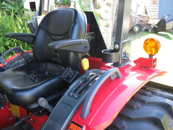

To start with, my dealer installed a canopy, a Mahindra factory rear remote, and exchanged the Mahindra OEM spring seat for a 7520 OEM suspension seat for a minor up charge. :rolleyes: In hindsight, I probably would not get the OEM remote again. Besides it being a little costly, it doesn't work how I feel that it should work. It is a 4 position valve which is good, but when it is in float mode, the 3pt will not pickup. :( Not that that has hindered anything yet, it just seems that it is not right, to me anyway.
All the other improvements I have done myself.

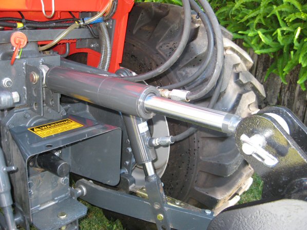

I built a "TnT" set, as in fabricated the cylinders as needed to match the factory links. Installed a standard double valve with float position on one of the valves from Surplus Center. Built the hoses myself from parts that I bought from Discount Hydraulic Hose. Installed needle flow control valves on each valve to be able to reduce hydraulic flow as needed.
Installed an ammo box behind the seat and reinstalled the SMV sign, you can barely tell that it is there.:) It is a bit tight though, and is easier to open with the seat slid forward.
After contemplating where to put a cup holder, I decided that It would be the easiest to just mount it at the base of the ROPs next to the fender. I used a piece of aluminum to mount a 3" ABS cap to the ROPs.

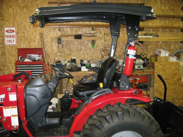

Mounted a fire extinguisher to the ROPs.

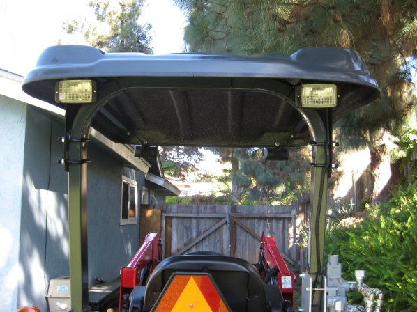

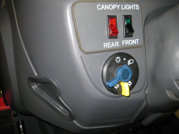

Installed some 5"x 3" lights on the canopy front and rear. Installed some rocker switches that light up when you turn them on. The wife made some decals to put at the switches to indicate what they are for. :cool:

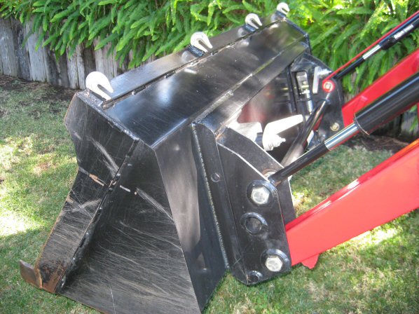

Reinforced the loader bucket and installed chain hooks. I used 3/8" plate on the sides and 3/8" 2x2 angle on the top lip before the 4 hooks got welded on.
Changed the ends on the 3pt stabilizer-sway bars where they mount to the tractor to ball ends. Waaaay better.:D
Here are some pictures that go along with the improvements.
Hey, do any of you that have a 2815 or a 3215 have a factory 3 position light switch?
Just wondering, they show the switch in the owners manual, but mine is either on or off.

Nice work. I like the ammo box. Where is fuel tank on the 3215? I have a 2615 and fuel tank is where you mounted the ammo box. My current tool box is a soft sided bag thrown behind the seat.
   / 3215HST improvements #3
On the 2815/3215 they moved the fuel tank to the front, between the engine and dash. Talk about a clean looking tractor, now I'm going to have to go out today and wash all the cat foot prints from the hood and seat along with the all the other dirt. And I thought I put the power washer and hoses away for the winter.
Just wondering if you could give the specs on your side link cylinder- stroke and overall length.
