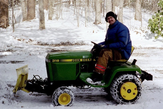

I get about 4 years on the idler spring. At 13 years, I had to replace all the spindles. Then starting working it too hard, and this year (19 years old) had to replace them again but due to wear and tear on the deck replaced the dec with a 48" one that was for the 300 series circa 1996 or so. Uses the same mule drive. The deck was torn up because I blazed a lot of trails in the woods and it ate too many rocks and stumps. I had to adjust it back into form with a precision corrector (sledge) many times. New place is mostly open, but mowing time for the last 4 years finished off the spindles. Got new machine to mow big areas with, now use the 318 around the house and for the very infrequent snow (pix enclosed) In the picture, I didn't have any weights on the brackets because it was such a light snow.
Here's the 318 with 48" deck. Advise if you want pix of the support mechanisms on the underside.
Pete

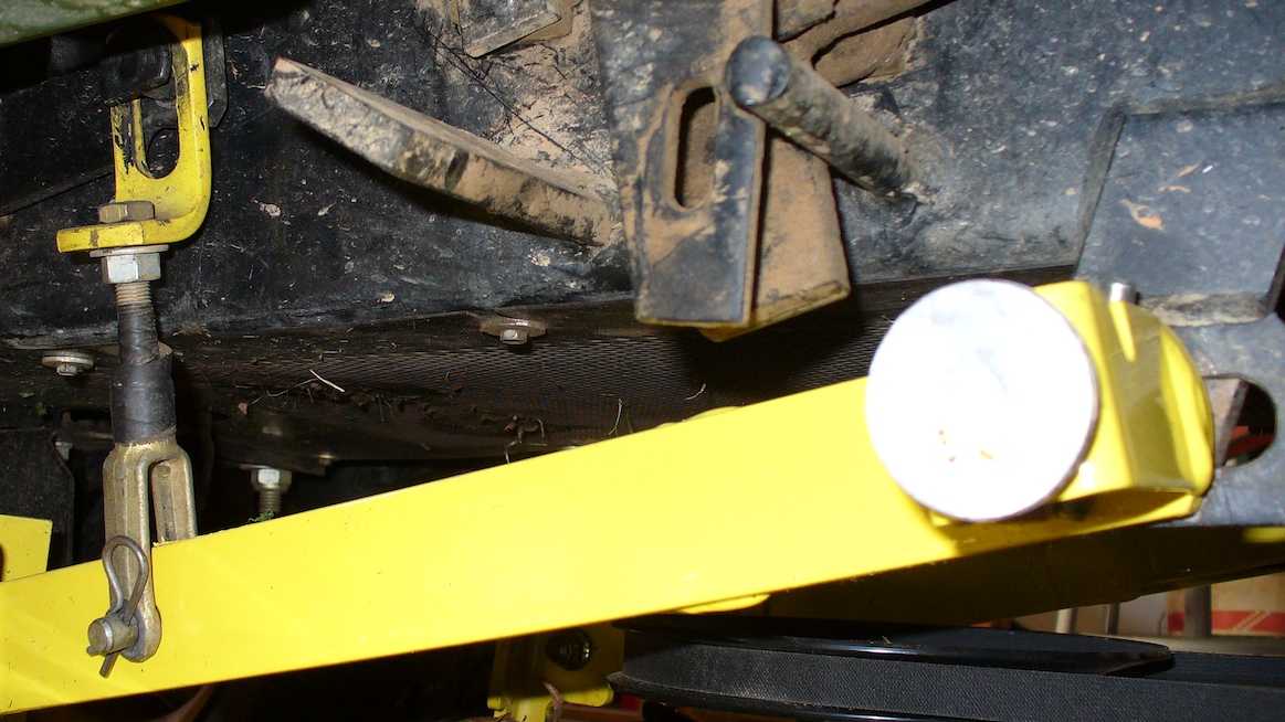

Here are some pix of the 318 mounting mechanisms.
There's a shot of the adjustable lift on the right side of the tractor. This levels the deck. The other side is a flat bar, no adjustment.

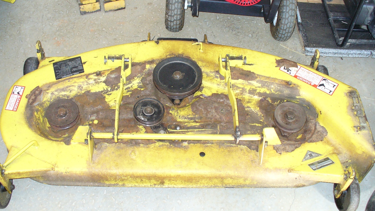

There's a shot of the 50" mower deck without the blower. Only the center spindle has dual pulleys on it. You can also see the rusty idler spring. The idler pulley has a nylon spacer you need to check every year. Buy a spare spring and belt now. Buy a spare mule drive belt now.
There's a shot of the mounting mechanism for the lift post. This is the one you put on by tilting it on at a 3:00 position, then sliding it down to 6:00 where it stays and lifts the deck. Do it the 1st time lying on the floor mumbling to yourself, then you can do it blind from there on out.
There is a picture of the height adjustment at the rear of the tractor. The cylinder is just below this. The nut adjust the height. If you use any front attachments (like the snow plow) this cylinder also moves with the side to side lever.

Take the model number from the mower deck and go to the JD parts web site, and you should be able to see the pattern that belt goes in. Do not look up 318 tractor as it will not show the mower. You NEED the model number from the mower! It is really wierd the way it runs through there. The spring loaded tensioner will only be in the slack part of the belt. Power enters the deck on the center spindle and goes out from there. After you get it on once, take a marker and outline it on the deck so when it breaks, which it will, you can put it on easily. Only get JD belts, they like to make odd sizes so nothing generic will fit and work at all. Keep a spare deck belt around you will need it at the worst possible time.
Just saw picture on the post, belt comes off of the right side of the center pulley, comes back around the tensioner, and the goes out the the right blade, comes all the way across the back to the left blade, at back to the center blade. As you turn it the only part that is not transmitting power is the loop around the idler. Make sure it is as tight as you can make it, or it will slip.
