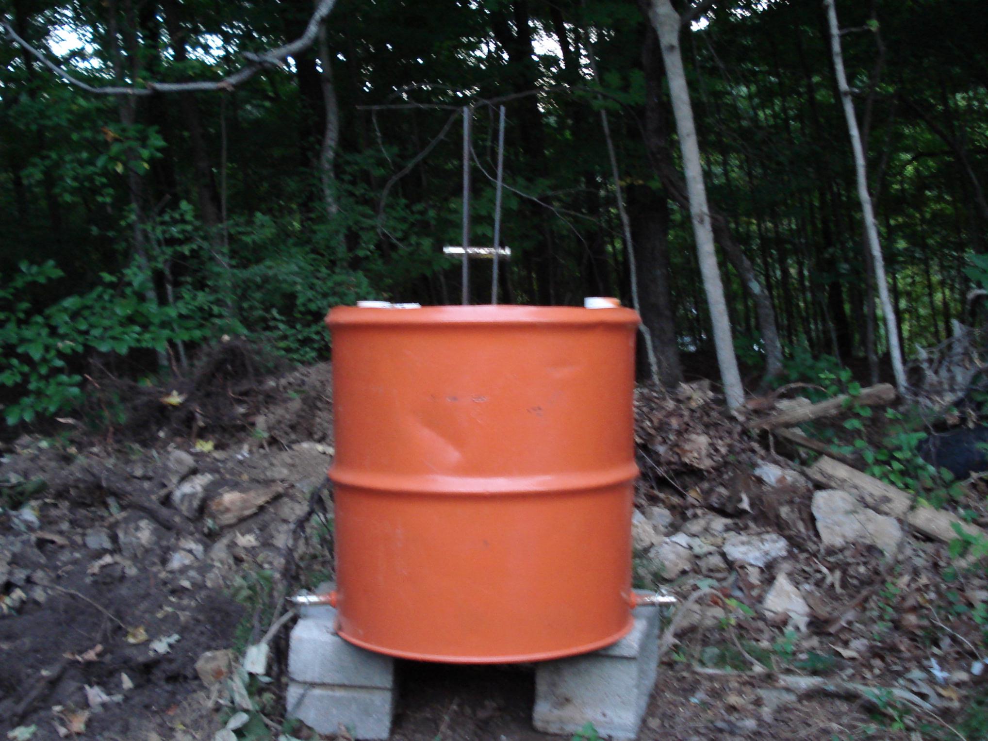

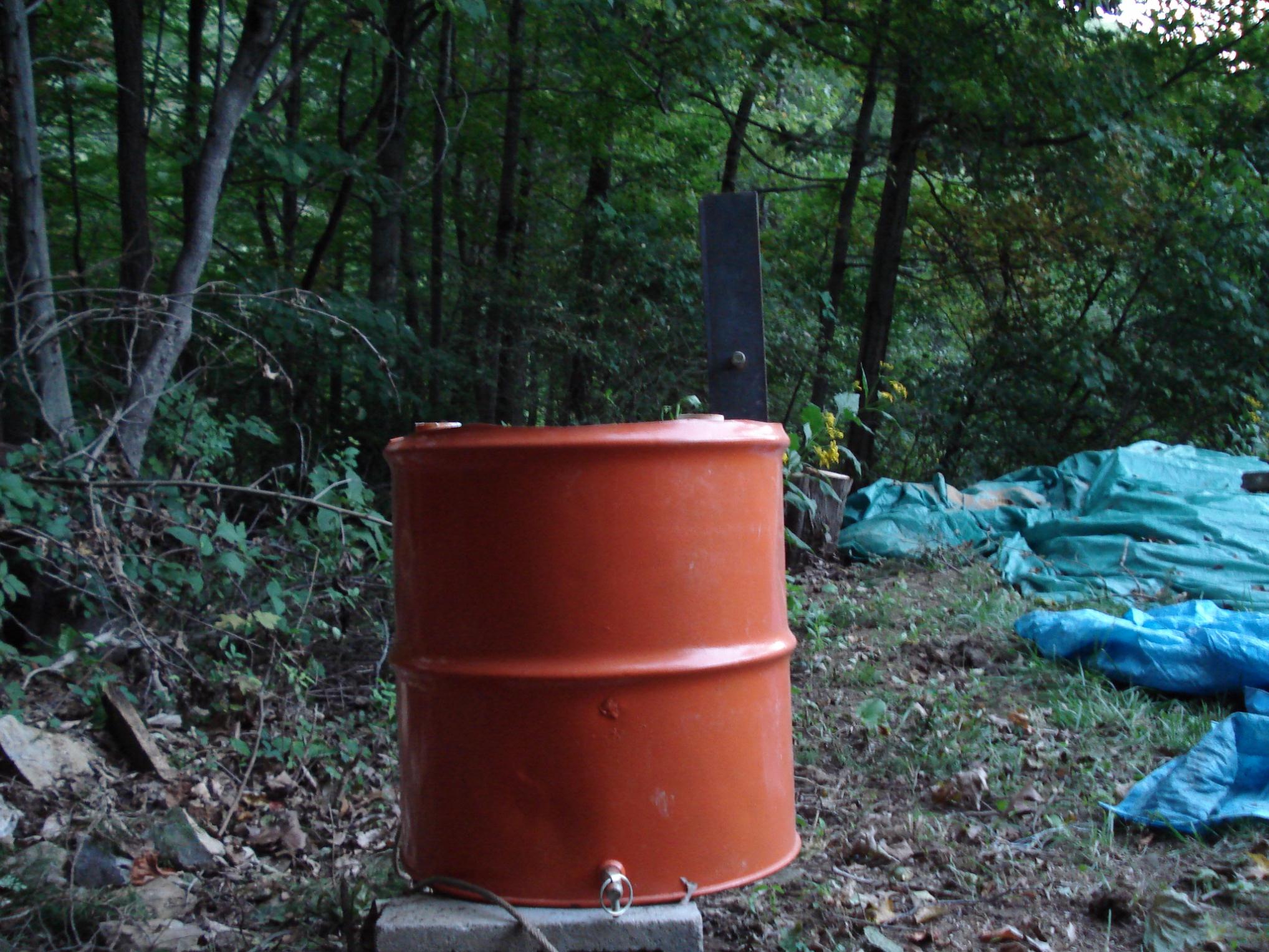

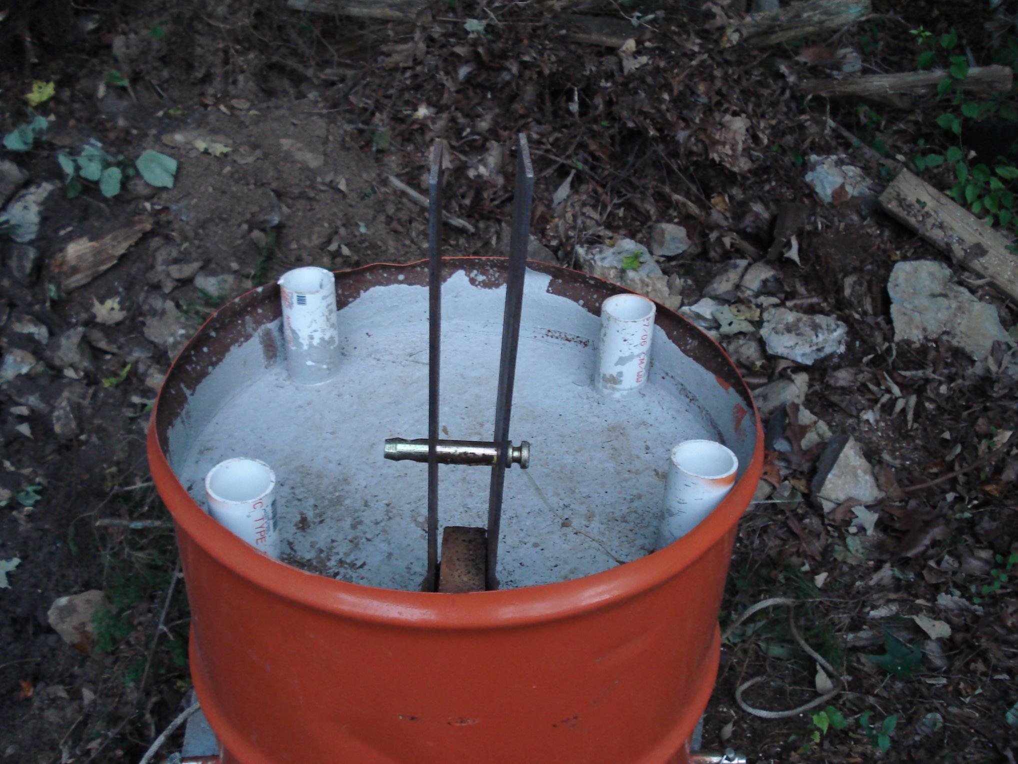

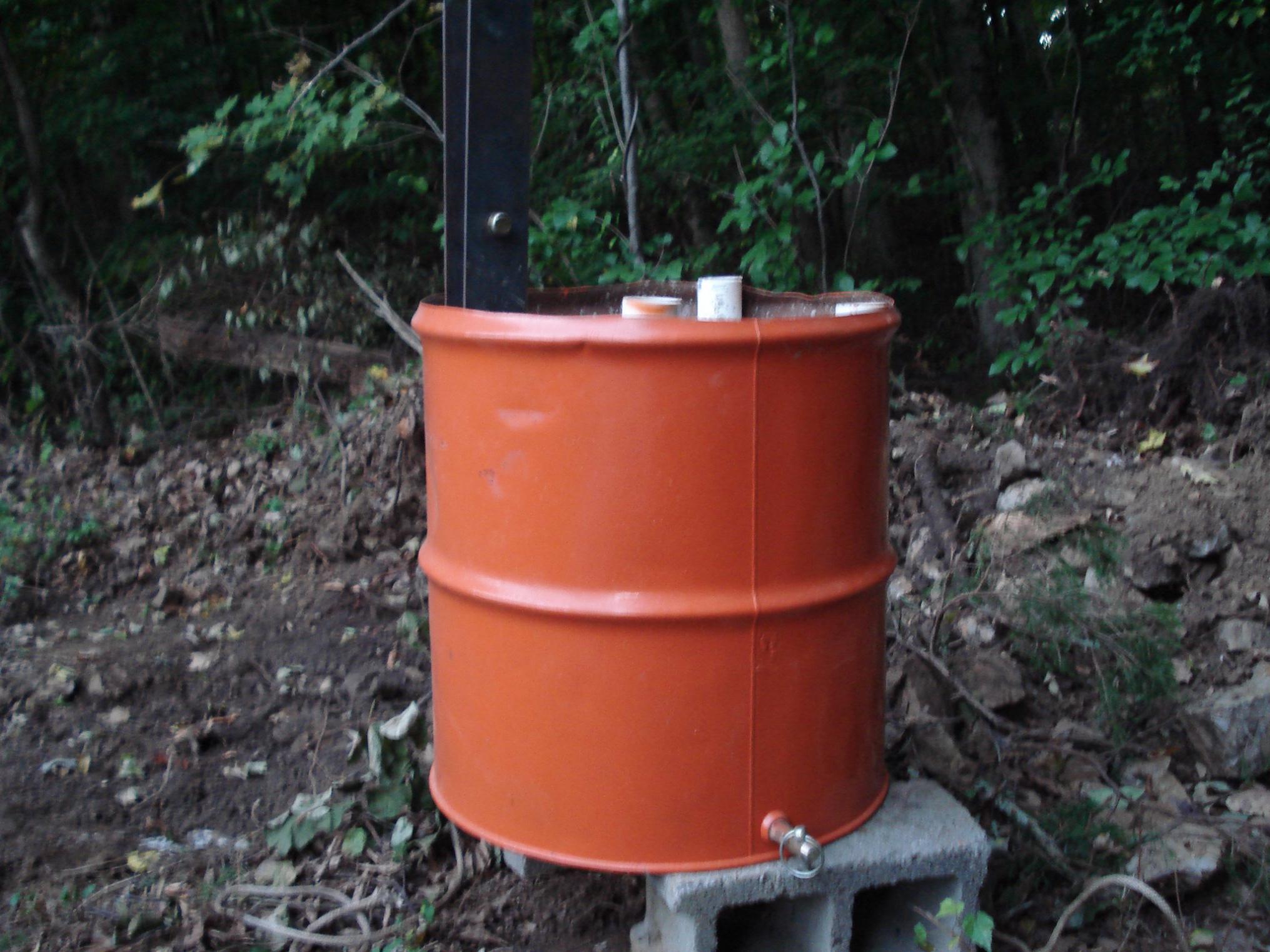

Hi Bruce,
As promised, here are the pics of the 3pt counterweight I made for my 3130. I got the idea from something my grandfather built for his Kubota, and from many great suggestions I read in the Attachments forum. The total weight comes in around 600lbs.
In case you're wondering why I didn't fill it all the way to the top, I use the leftover space in the drum to carry miscellaneous crap I need. You'd be surprised how often you're looking for a place to put something when you're working with your Kubota :)
In general, with my filled tires I don't have any stability problems doing "normal" or light loader work. But when I really need traction for scraping/digging with the FEL, or for heavy loader work, I bust out the counterweight. With that on the back, I can easily max out my loader before my rear wheels ever leave the ground.
Hope this helps you,
Ben

/ 3130 rear wheel stability #5
Cupholders ?????
/ 3130 rear wheel stability #6
The 'cupholders' are for storing straight handled tools, such as shovels, rakes, hoes, etc. Things that come in handy when you are working with dirt.
If you look on the 'Attachments' forum, there are tons of great articles on building counterweights like mine. In fact, the idea for PVC tool holders came from suggestions on that forum.
