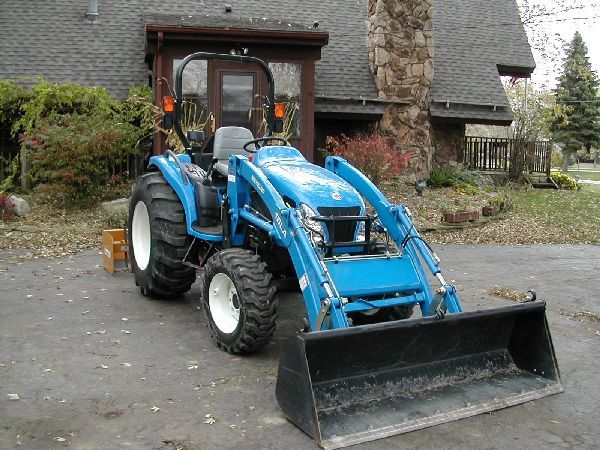

DaNag; Not sure if this will be of any use to you, but, I have the NH 16LA loader with heavyduty bucket. I do not abuse equipment but I did manage to dent the top of my bucket when I went into a tree to push it over. No damage to the rest of the bucket and it's only superficial. I'm glad I didn't get the lightduty model. I have the bolt on cutting edge along with Markham toothbar. True, you can only use one or the other, but it's really no big deal to unbolt the cutting edge and bolt the toothbar on. I think you'd be better off with the HD bucket regardless of the price and "inconvience" of bolting and unbolting. Also I've modified my bucket with a 3/8" grab hook welded to the center and tow hooks scavenged from a Jeep on each end. With the bolt on cutting edge your not wearing your welded bucket edge down when pushing dirt/snow etc. on a paved or blacktop surface. The 16LA loader uses a 72" bucket. I'm very content with my setup even after the battle with that particular tree. Hope I may have helped. The Markham toothbar is a great investment, you'll not go wrong with those guys.
Happy loadin' /forums/images/graemlins/grin.gif
