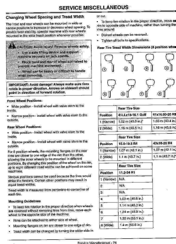

Can all 4 wheels be flipped for a wider stance on this unit?
/ 3120 question #2
Yes. See attached page from the operator's manual. Just be sure the rear wheels are in the wide position if you have the 448 backhoe. The backhoe "pins" will not have enough clearance to be removed when detaching the backhoe. Don't ask me how know this. Something a dealer should have known... /forums/images/graemlins/shocked.gif
/ 3120 question
cool, thank's for the info. I dont have the backhoe yet, just the 300CX loader which I operate on rough uneven sloped terrain mostly, until I transform it into "smooth" sloped terrain.
