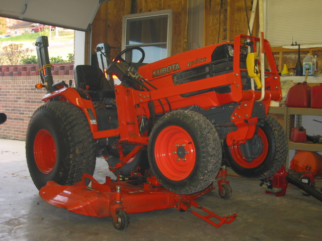

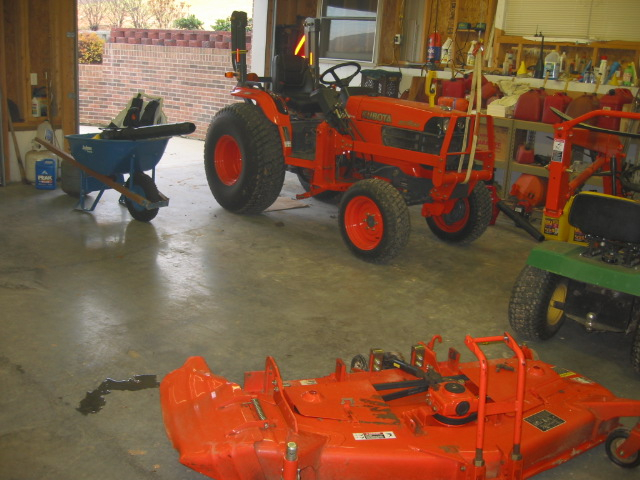

3 minutes removal / re-installation. One minute storage. Anytime I need to.
Keep both machines. 1880 for dedicated mowing, 7800 for chores, projects, and acreage mowing. Overhead hoist is the ticket for me.

HA sure if you have a nice level cement floor. Try it out in the yard.
