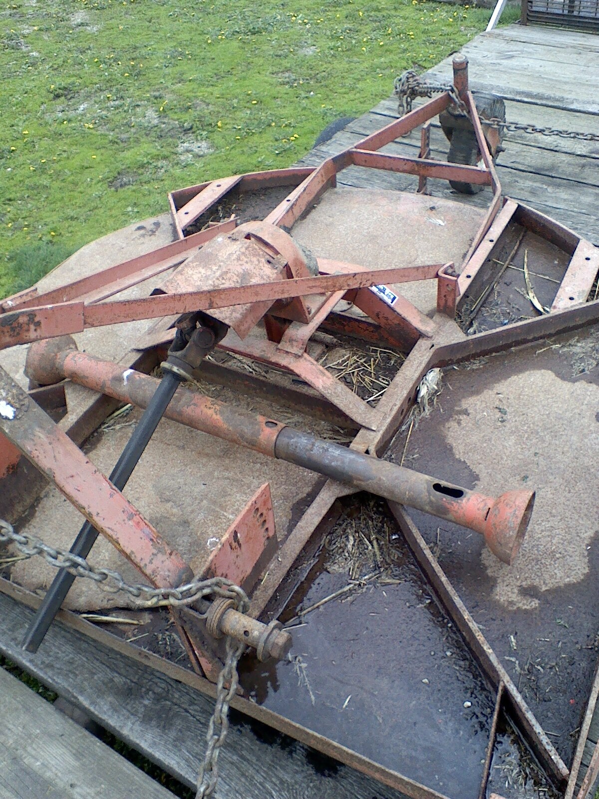

I saw a bush hog on the side of the road ,it was a 5' 305 Bush Hog brand that was rusty ,but didn't seem to be beat to bad. Called the guy up and he wants $750 firm . Looks to be really rugged and the blades looked to be hardly used. Would this be a deal or not ?I only have a 3240 kubota with around 25 or 26 at the pto so I didn't know if I've got what it takes to run it . anyone have one or used this one before?

Not sure if price is good for Hog as a picture is worth a thousand words. But you are kidding right about your 3240 running it right? Cause that would not be a issue at all for your Grand L, it would run it like a breeze.

The model 305 Bush Hog mower is a heavy duty cutter. MUch more so than ANYTHING you can normally buy in that price range. I'd be all over that before it had a chance to get away.

Probabally not a bad buy. But definatally no steal. I just picked up a 306 (same thing but 6') for $200. I consider that a steal. It was rusty and had a tear in the deck. But when I get done repairing/repainting and making it like new again, I am hoping to get ~$800 or a tad better out of it.
And age makes a difference as well. I think they made the 305/306 for almost 30 years. They started in the late 70's or early 80's and made them up until a few years ago. If your's is a newer one, definatally not a bad buy. If you price any HD bushhogs today, you are looking at $2500+ for one built that rugged.

Back to the original question....The Bush Hog 305 has the "specs", and it has a proven track record as a commercial grade mower. If it were a 5' BH Squeeler, I'd walk away on that price. The thing is, it's NOT a Squeeler, nor is it a King Kutter, or any other economy level mower. Relative to what you'd have to pay to get a new mower of the same grade as the BH305, I'll stick with my opinion. I'd jump on it at that price.

Hey, thanks for all the good advice, I'm going for it. Money's tight right now but by the sound of what your saying for the price it's not bad.
