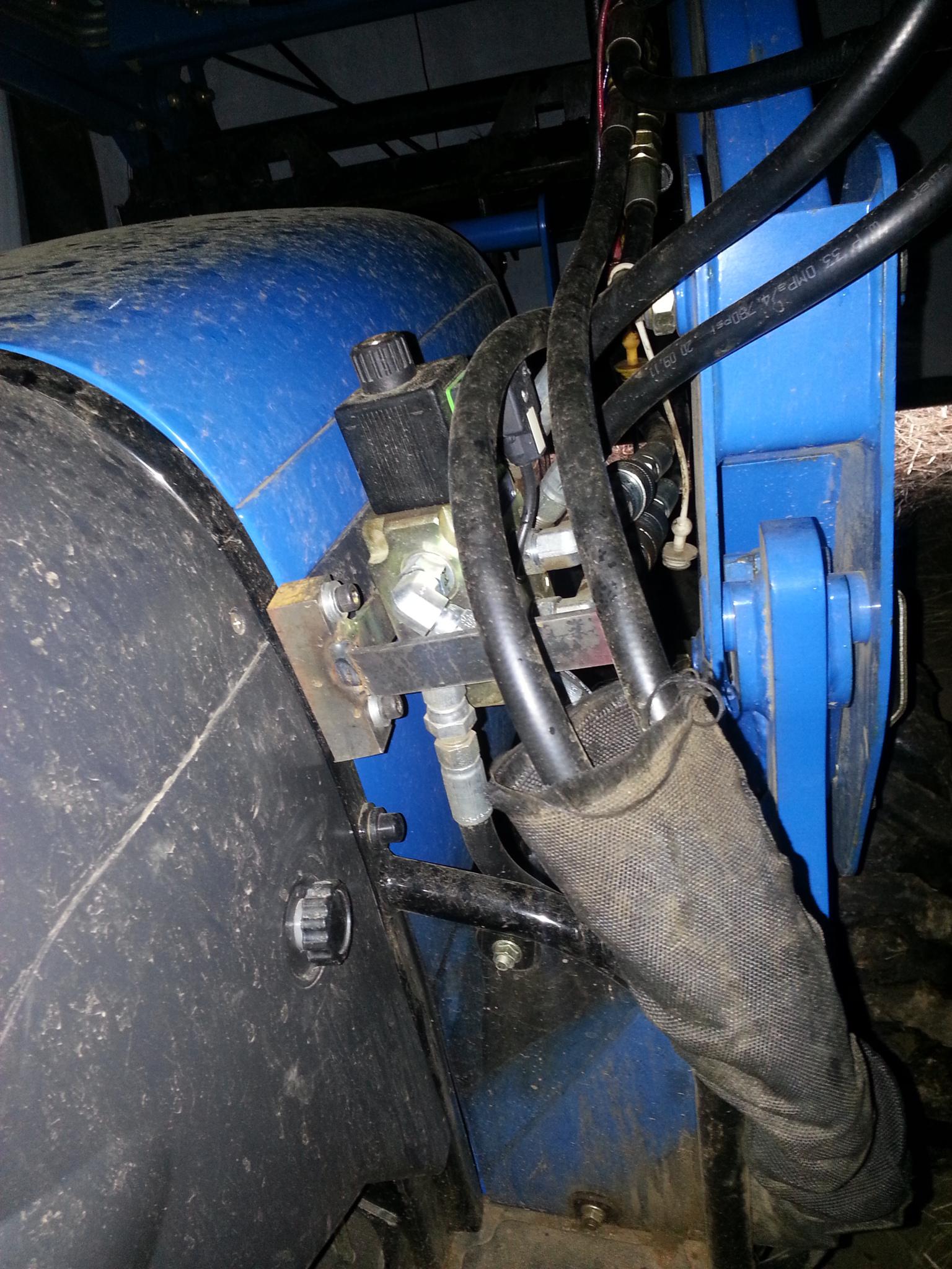

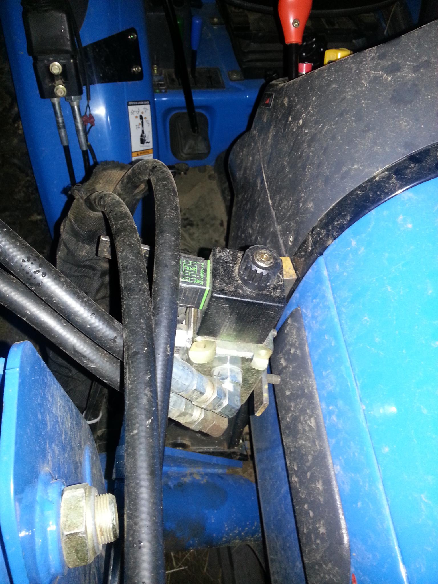

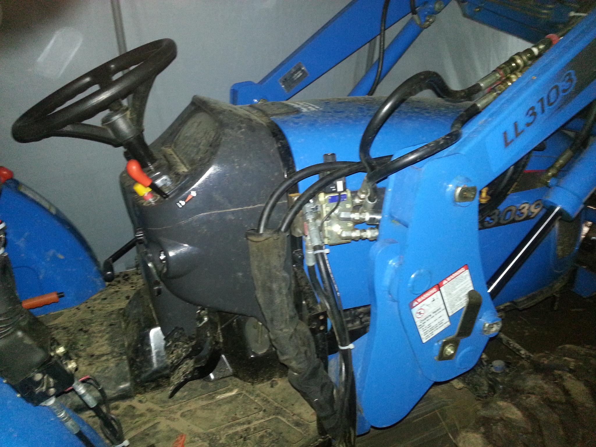

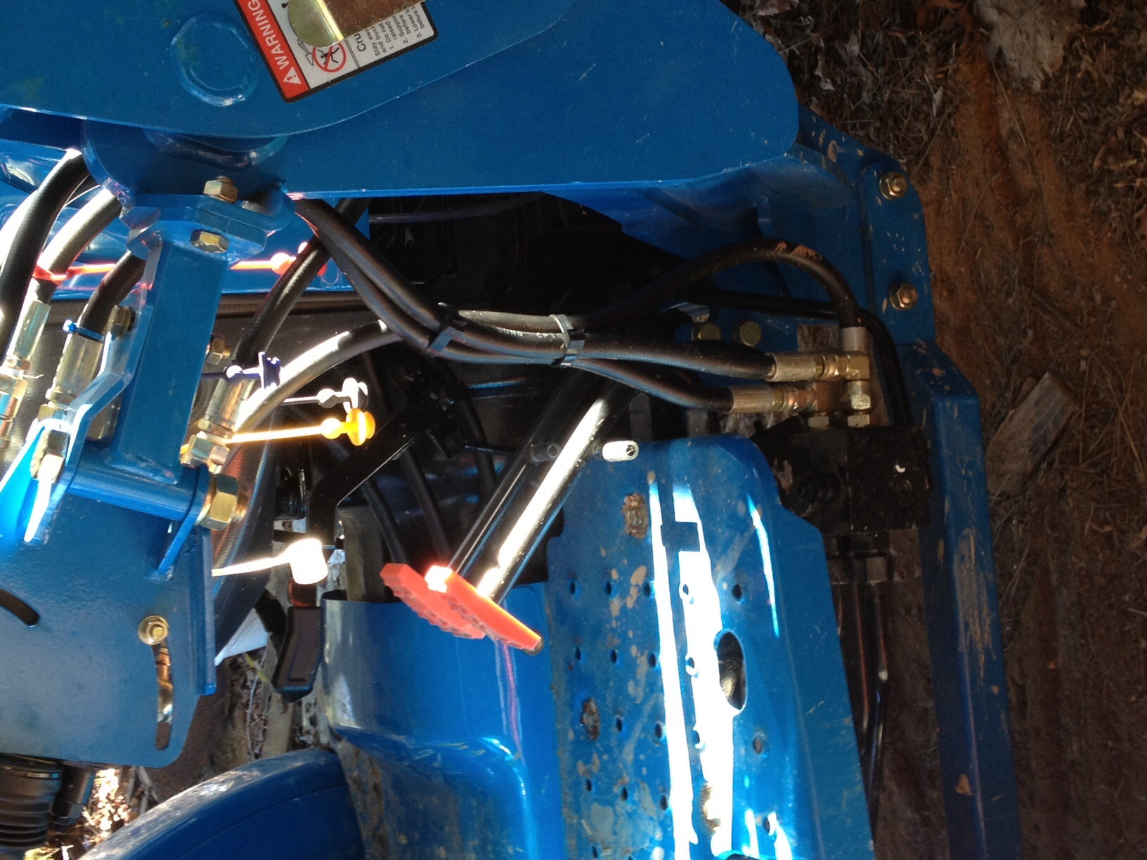

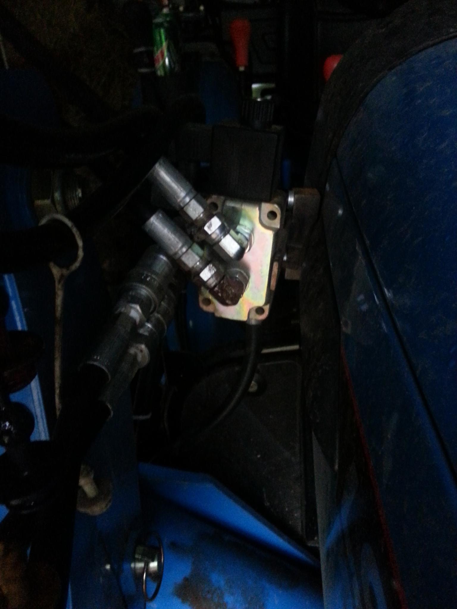

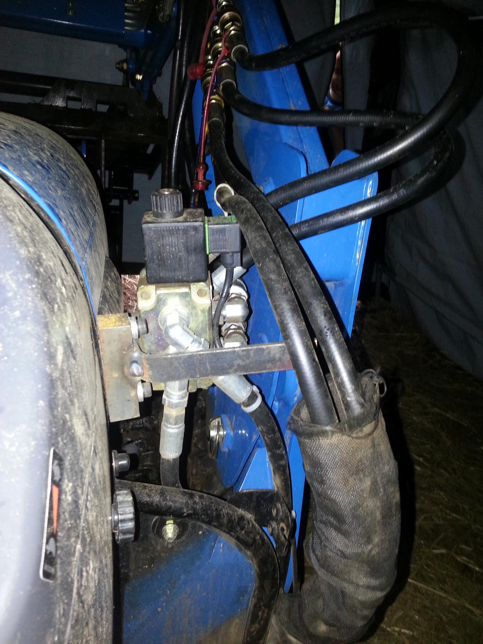

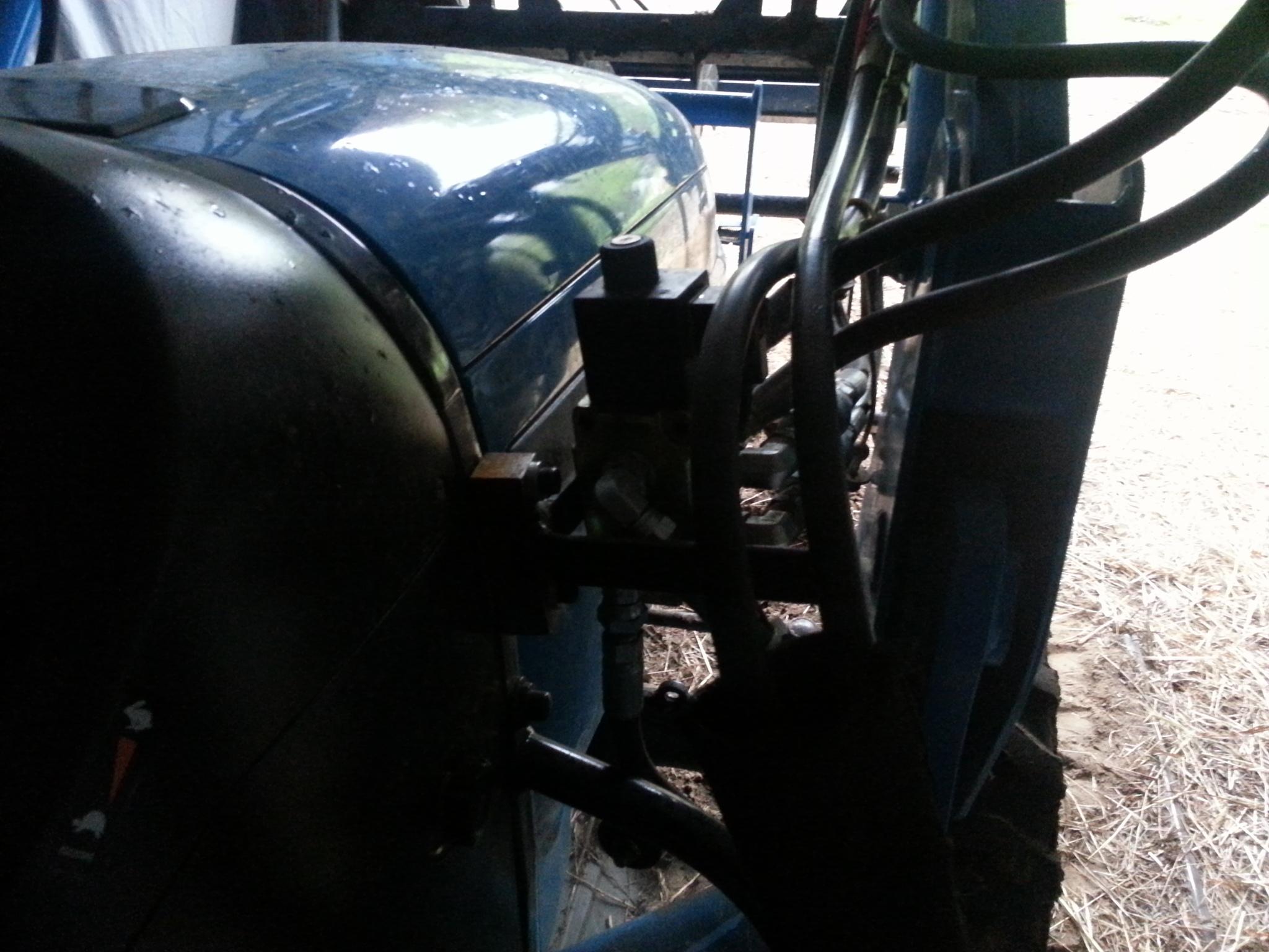

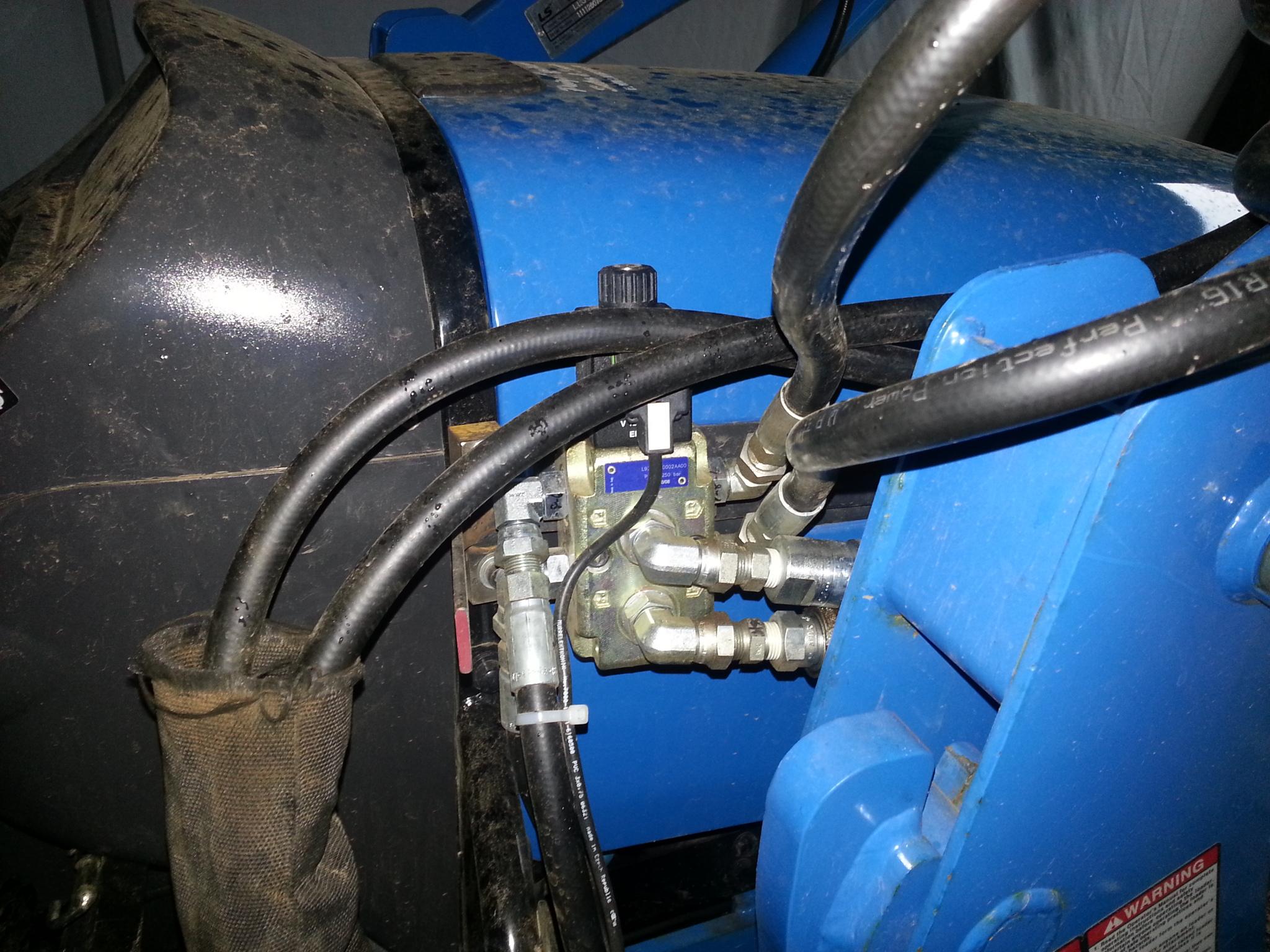

See if these pictures help. This is how I did mine...

Just want to be sure what we are talking about here. When you say 3rd function, are you talking about a 3rd function diverter as shown in 580s pictures, or are you talking about a true 3rd function where the valve gets plumbed into the power beyond circuit and the valve HAS to stay with the tractor?
In my opinion, the best mounting location for the diverter type is on the loader tower between the loader and the hood. That is as long as everything will fit. That is where I have it on my Mahindra 3215.

I didnt have room for mine on the loader tower, so I chose the next best spot. I have 2 extra hoses to disconnect if I pull the loader off, but its not that bad.
I was able to cut and have the local shop put new ends on the existing hoses using the method/placement I took. It worked out quite well for me.

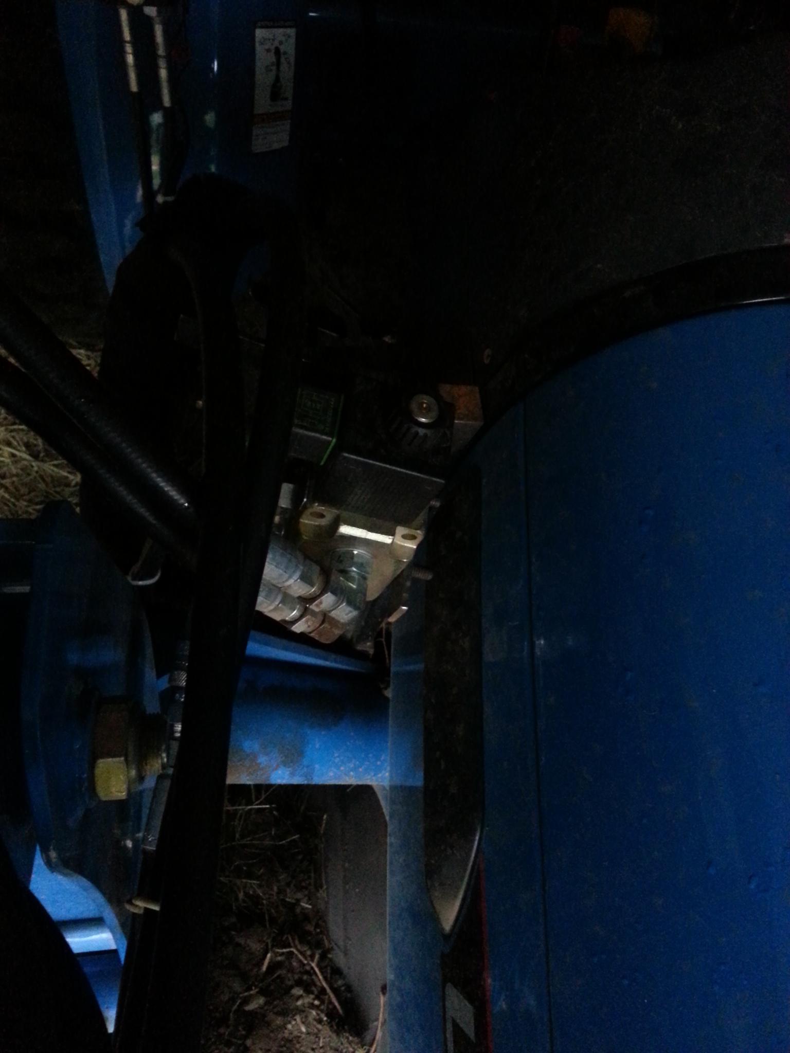

A true 3rdfunction valve. The only place that seems like it will work will be to add a plate between the "valve bracket-bottom" and the FEL top hinge. No room under the deck as block takes up space, and not a firm place around the hood like in pics above. Just not much space between the FEL and hood.image.jpg
   / 3038H and 3 rd function valve placement #8
The valves we sell get attached via a bracket to the top side of the loader subframe rail
