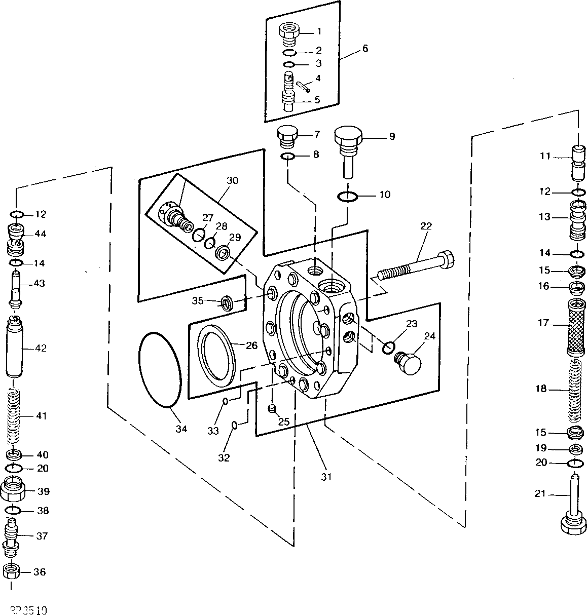

You could install a $15 destroking screw to relieve hyd pressure while attempting to start engine in cold weather. parts key #6 AR33249 SCREW 1 (MANUAL DESTROKE)
What type trans does the 3020 have?
