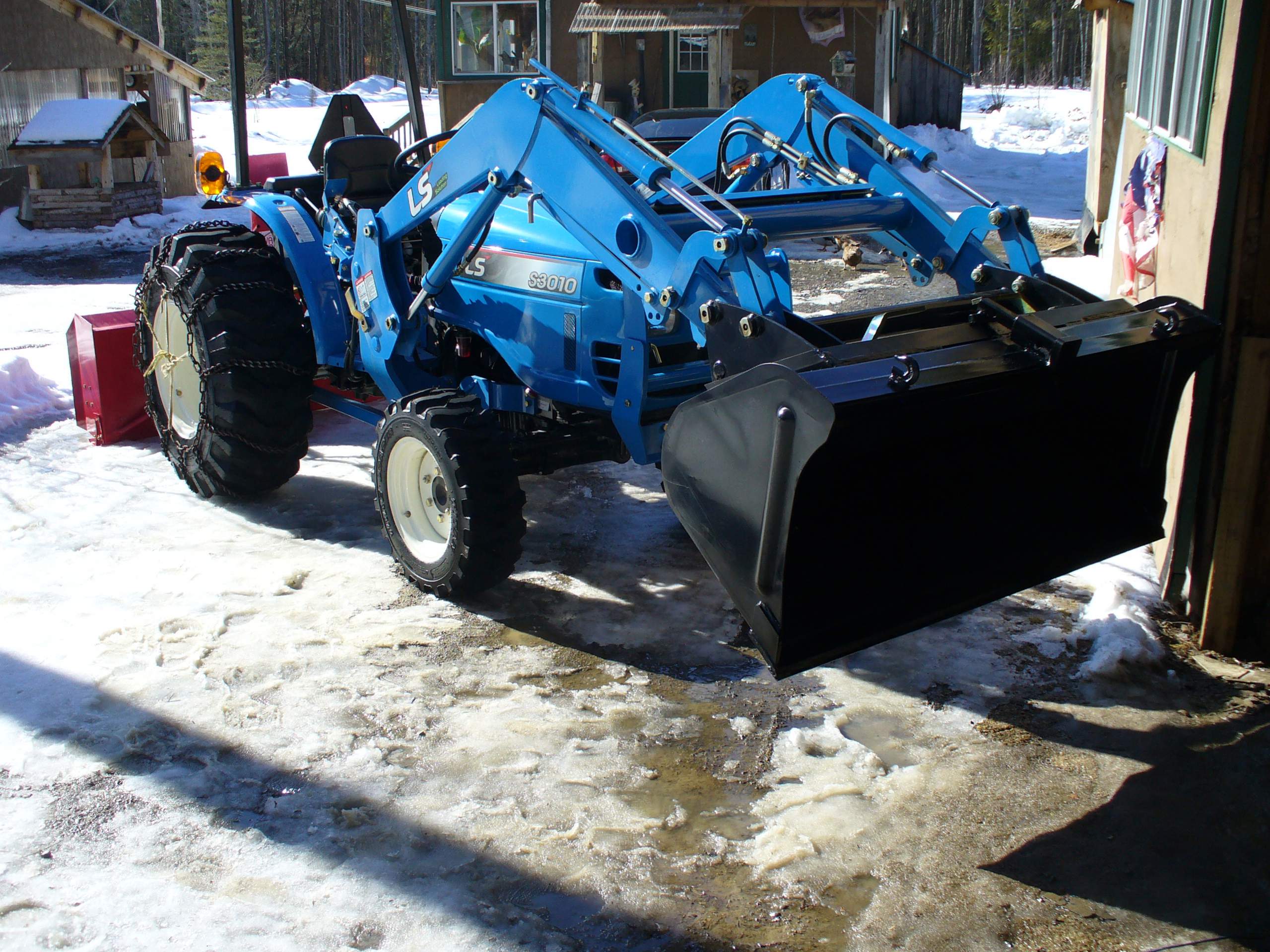

Hey folks I have 12hrs on the new LS, runs great, joy to operate. I have so far made chains for the rear wheels(modified and old set). Loaded the tires with washer fluid, made a big difference. Added a jinma snow blower rear mount does a good job, only thing I'll probably change down the road will be the chute adjuster. Today I welded two grab hooks and a center 2'' receiver. As soon as I can get my camera to work I'll get some pictures.
Okay it looks like I got it to work

Hi 20 20, I like the idea of 2" receiver on the bucket instead of a center hook especially since you have hooks on each end of the bucket. I think I'll do the same!
Thanks for the idea! solinski
/ 3010 personal mods
I'm planing on making some sort of cab for it also along with other little things.
Solonski; I got the receiver idea from this site can't remember which thread it was though. I wanted it for one main reason to use a receiver mounted vise to hold chain saw while sharpening. Now that I've installed it I'm sure there will be many other uses:)
