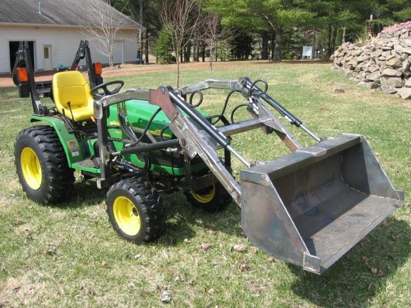

My 70 R loader was less than $900. with components and tax. The cylinder rods are 1 1/16" and have no problem lifting the rear tires with a counter weight. It will lift 8' and at 2100 rpm cycle quickly.
When I looked at adding a 200cx loader the extra mounting kit required for my application, tax, and shipping was just short of $3500. I just couldn't see where value, met quality. Granted every owner may not have the time, patience, or tools to fabricate a loader but it was the best choice for me.
