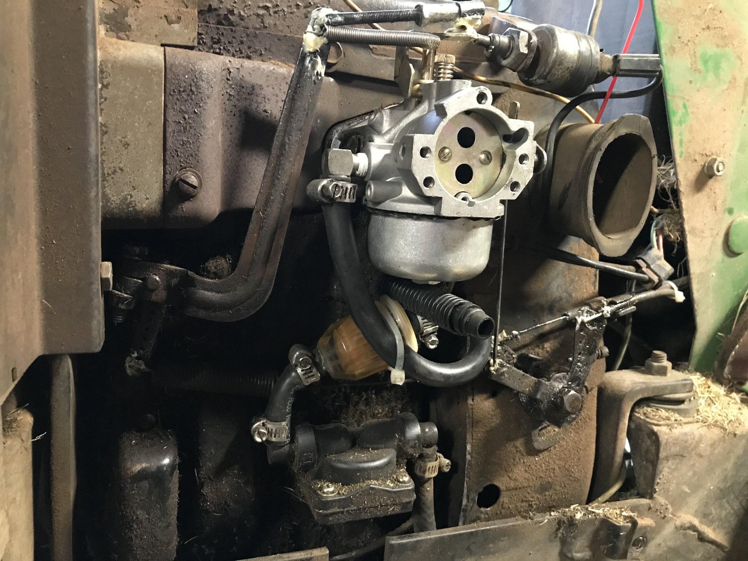

My fuel pump was bad, but the filter could use a clean I'm sure. How do I do that? While I had the pump off I did blow compressed air back from the inlet line.
Unfortunately blowing air back into the fuel tank will not remove any debris that may be clogging the strainer - it will just spread it all over the tank bottom.
The drain valve (shown in your post #18 year ago) will have to be removed for strainer cleaning.
I addition to cleaning up the strainer, I installed a generic inline fuel filter on mine little over two years ago. It was a little tight to make it fit and a little shorter filter next time will make it lot easier to install.
(The filter body is 1.75 inches long)
That's a cheap new carburetor from eBay vendor which has worked very well for over two years now.
The original carburetor had the throttle shaft worn way too loose and new OEM carburetor kit would have been around $300
