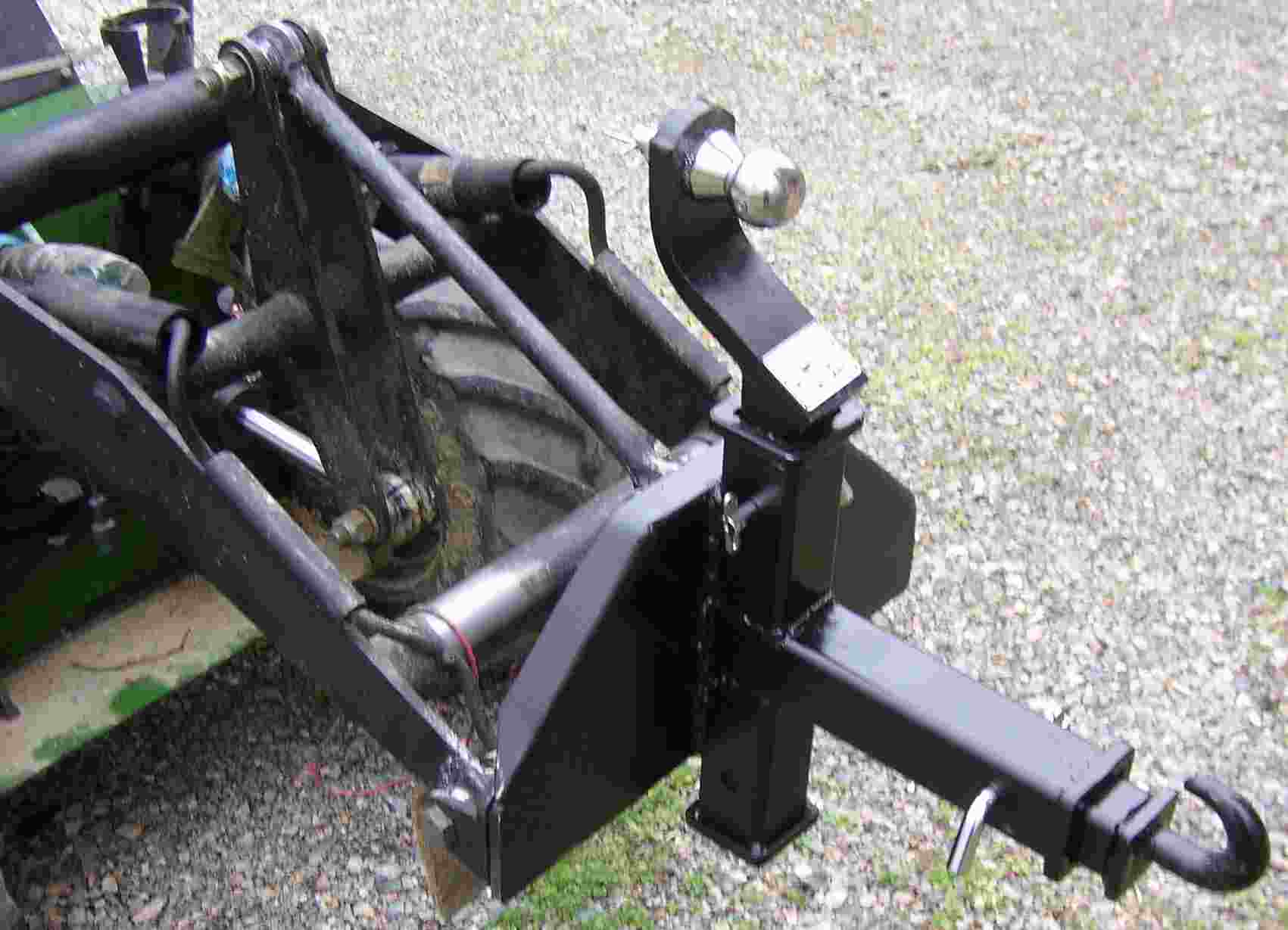

Today I welded three two inch receivers to a quick attach plate. I used one that is 12 inches long and it sticks straight out. I made it longer so I could see the ball when attaching to the trailer. The other two are six inches long and one goes up and one down.
See attachment

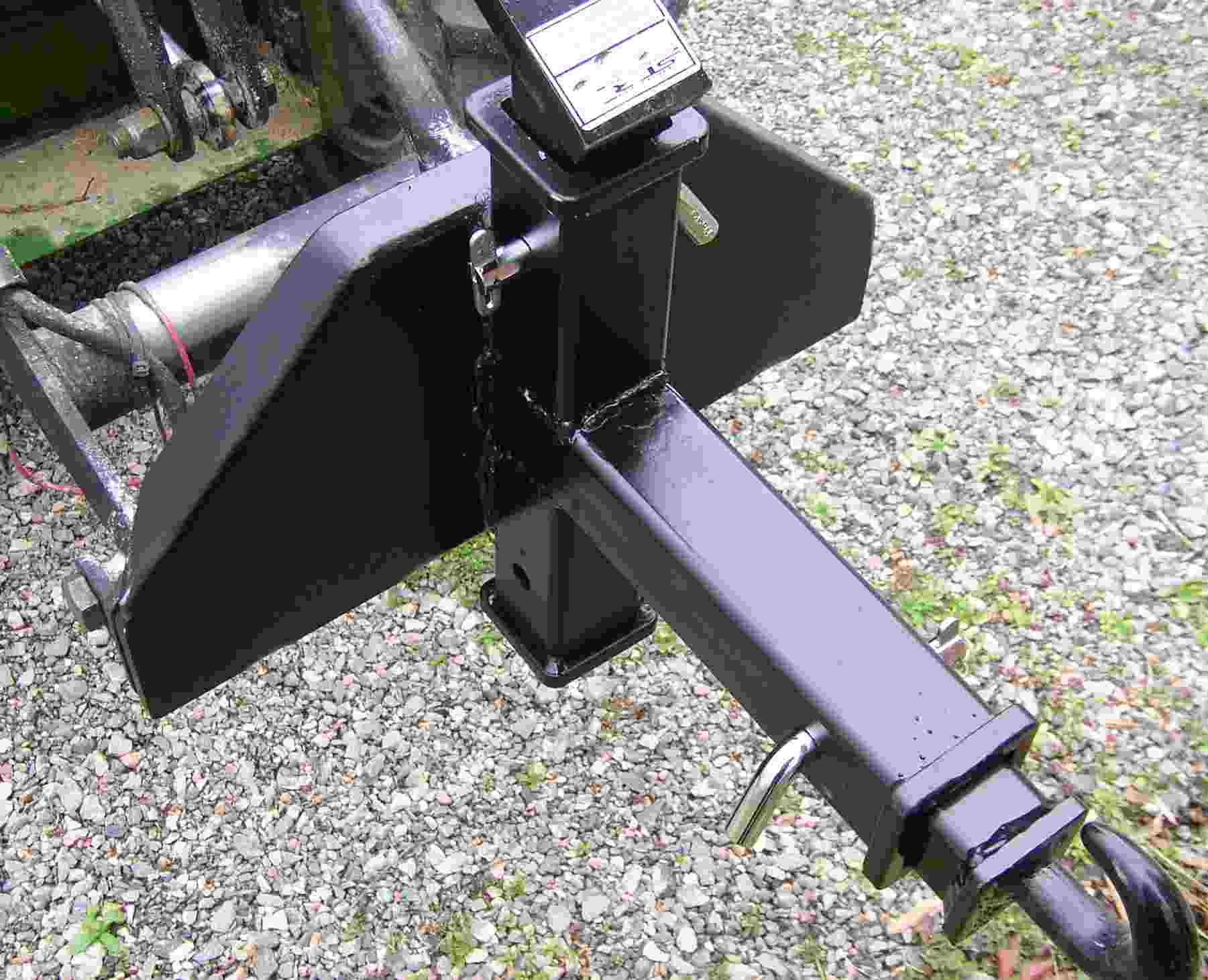

Pardon my welds, but I have never taken a class, just read a book.
I hope this is strong enough. I did not put any reinforcing brackets, hoping that the three receivers would reinforce each other. What do you think?
I did not realize it while designing this, but the top receiver makes a good storage place for attachments not in use.
Now I need to come up with some other attachments with two inch receivers. Any suggestion?
I have attached anther picture that is a little closer view.

I would add some 1/2 in gussets to the top and bottom of the 2 in receiver. 4 in triangle should work fine. What is the purpose of the bottom receiver? You could put a ripper in there, or a pipe puller. The top receiver could be used for a goose neck trailer. A log splitter assembly could be used in the front receiver. You might get 400 to 500 lbs load holding capacity.
   / 3 Way 2 inch receiver
I will add some gussets. Do you mean 1/2 inch thick. Wow! I have some 1/4 plate. Is that enough? Also do you mean connect the middle receiver to the top and bottom receivers with this gusset?
I was thinking that the bottom receiver would be good for a root or dirt ripper. I have some old brush cutter blades. I was considering using one of them, cut short to 18 inches or so. How does this sound?
