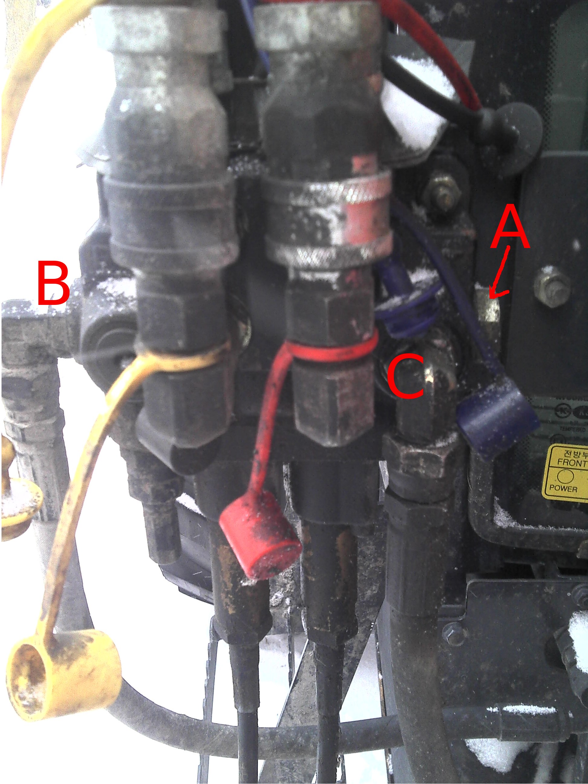

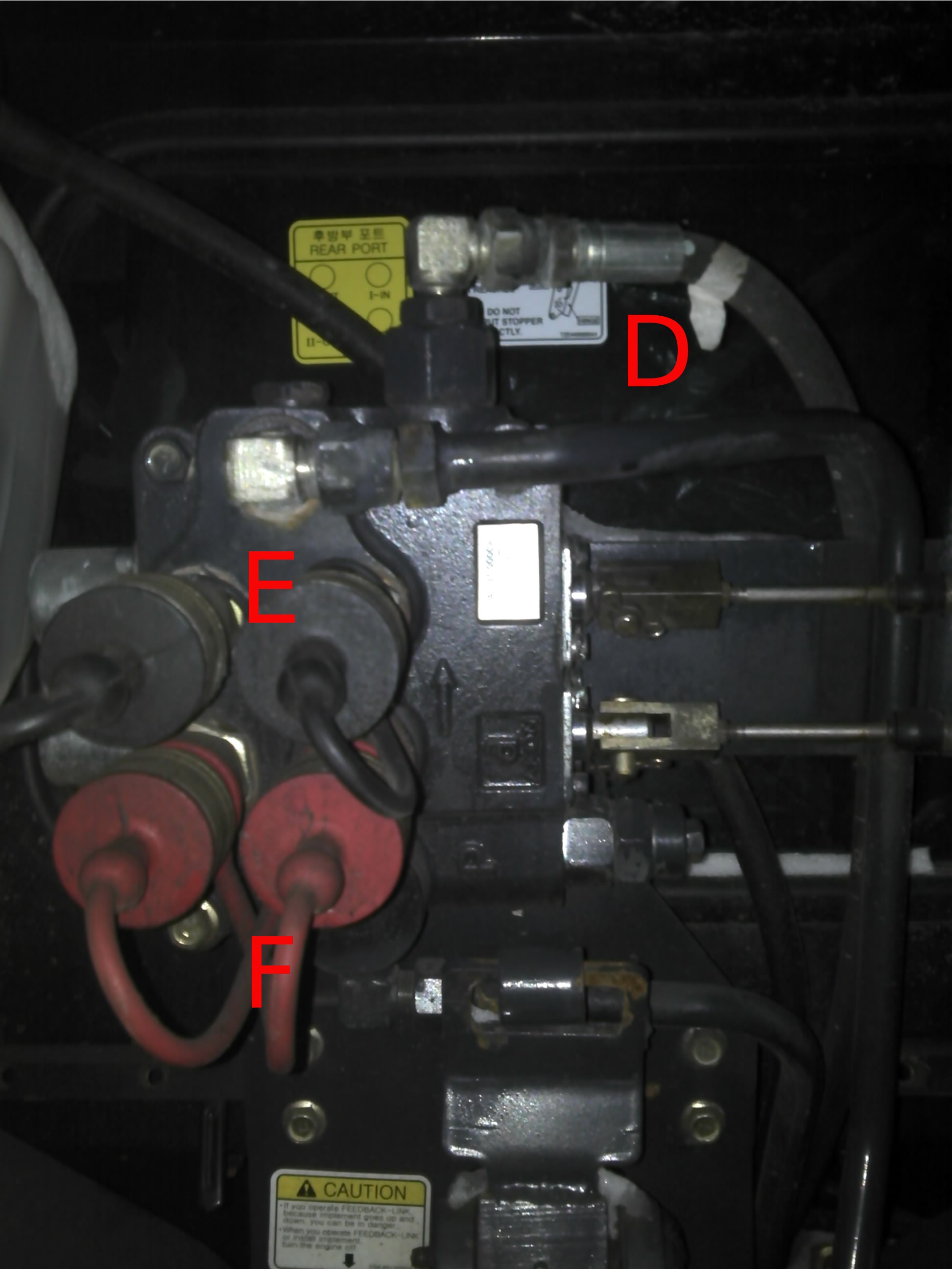

/ 3 rd function on a branson 6530
In this pic I have identify the P the T and what I think shoud be the PB.
A- is PB
B- is P
and C- is T
In the second pic it is the rear valves.
F- connect to the hydraulic case assembly with a banjo fitting
E- connect to the hydraulic case assembly with a banjo fitting beside one that
goes to the fel valve, the P port
D- looks like its coming from the fel T port
So question is what is F for?
Would that be PB only connected to the rear?
/ 3 rd function on a branson 6530 #9
Both E, and F, are the two remotes, supply and return for any hyd attachments.
Then what is the use of D coming from the fel valve? And if the PB from the solenoid has to go to the remote then I would have to tee it off witch one?
/ 3 rd function on a branson 6530 #11
Does your FEL not feed the rear remotes through the PB port. The fluid path should be something like this, Pump, FEL, rear remote, 3pt, tank. The PRV in the FEL protects everything in the series circuit. If you plug in a log splitter, it will have it's own relief.
You don't tee anything, all valves go in series.
On the sub-plates, I haven't been able to find out the tank outlet max pressure . It could be equal to the pressure rating, 3000 to 5000 psi.

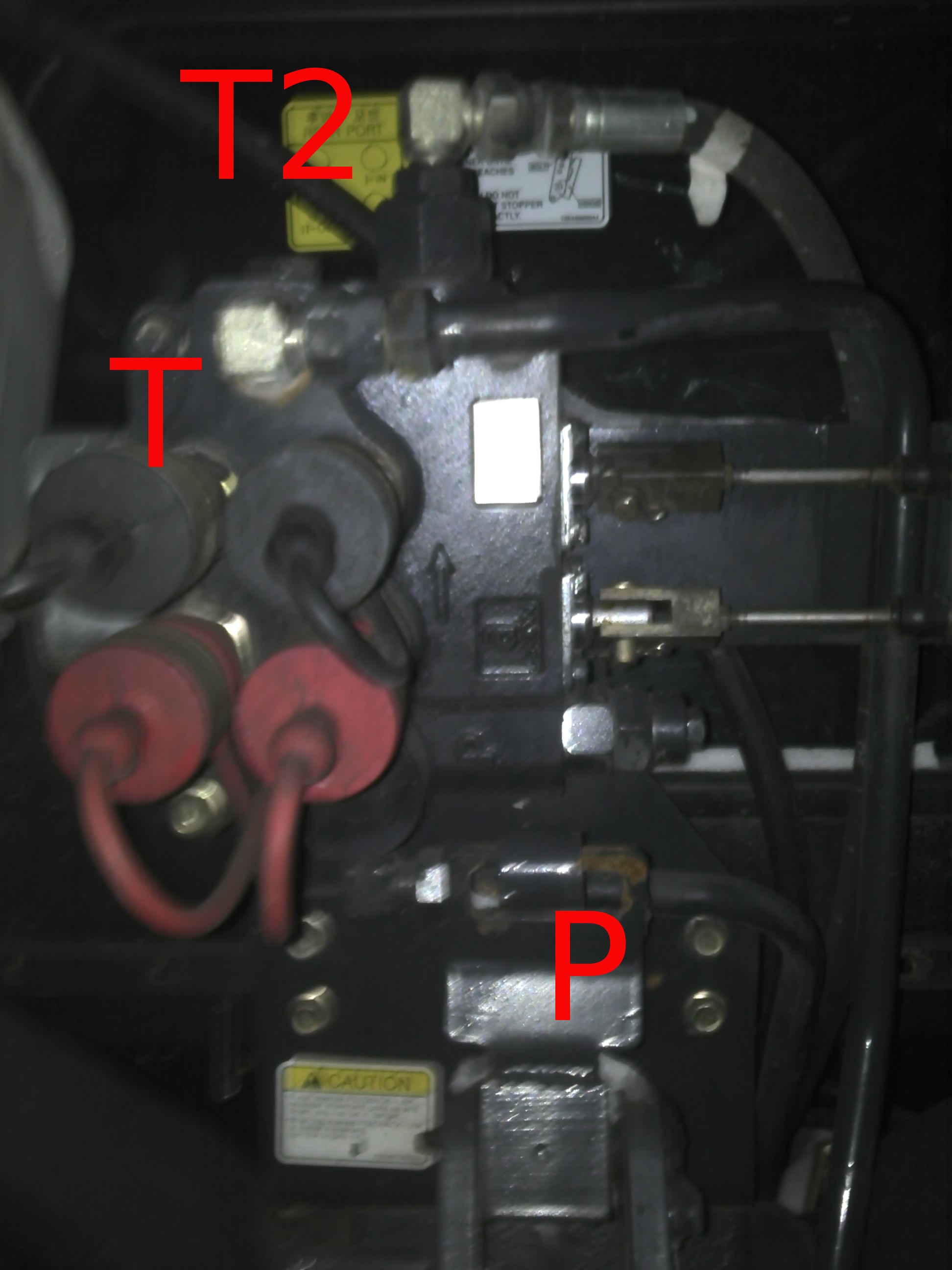

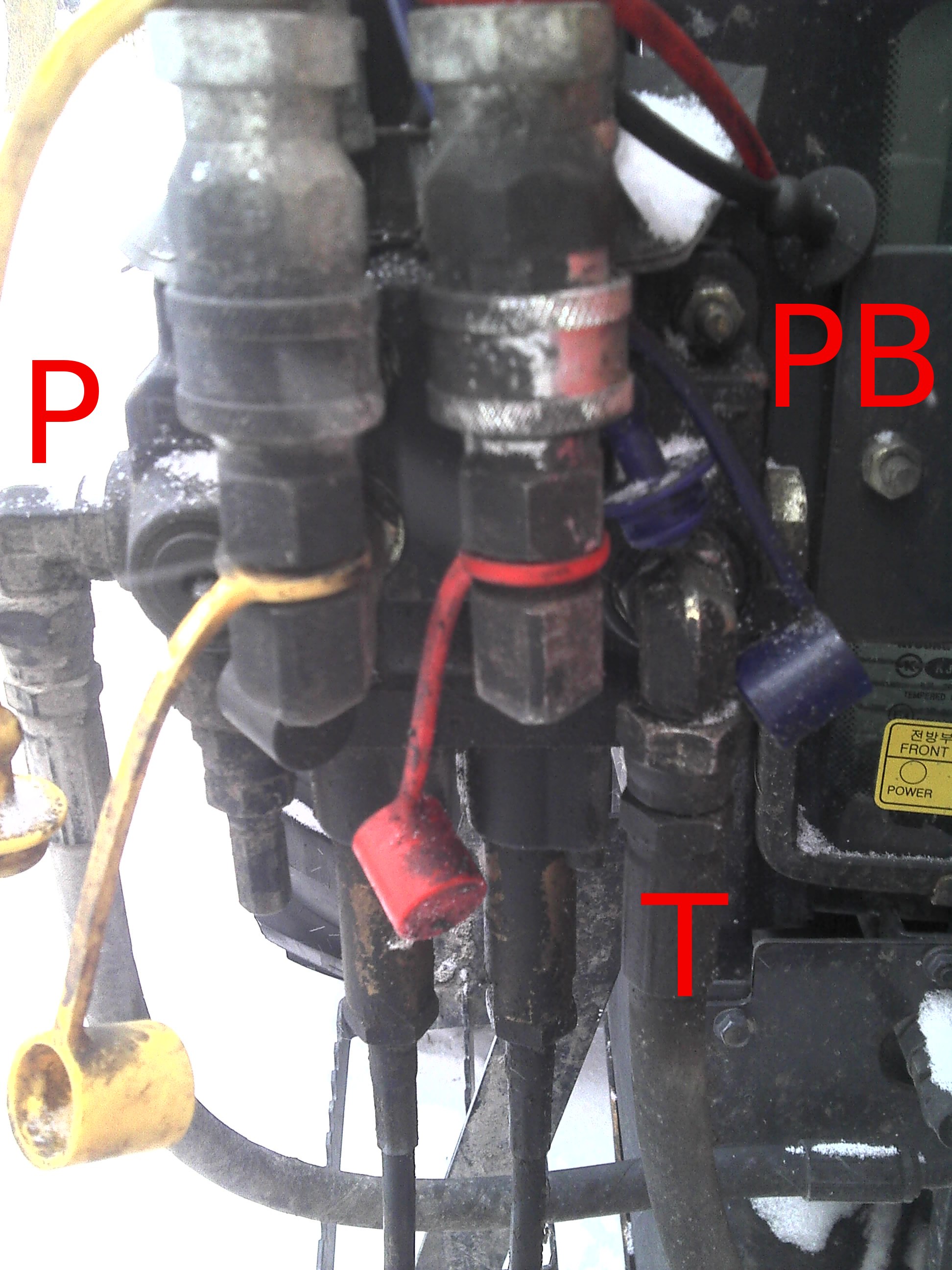

#17
OK I modified the picture.
The P comes from a banjo fitting on the rear axle.
The T goes to the rear remote valves.
The PB is not used yet.
And their is a spare port on the P side.
On the remote:
The P on the remote comes from a banjo fitting beside the one from the fel line
The T goes in the rear axle with a banjo fitting .
The T2 comes from the T of the front fel valves.
I found on a hydraulic web site information saying that I could supply the
3rd function from the PB to the P of the subplate then from the T of the subplate to the spare port ( P2) of the fel valve. Can that be done ?
If yes or no, what would be the results?
#18
For the sub plate rating I called it is 5000 psi.
/ 3 rd function on a branson 6530 #19
As long as there is a complete circuit and all valves are in series, and tank hoses go to tank.
#20
Actually the T on my fel valve doesn't go to tank but to remote.
