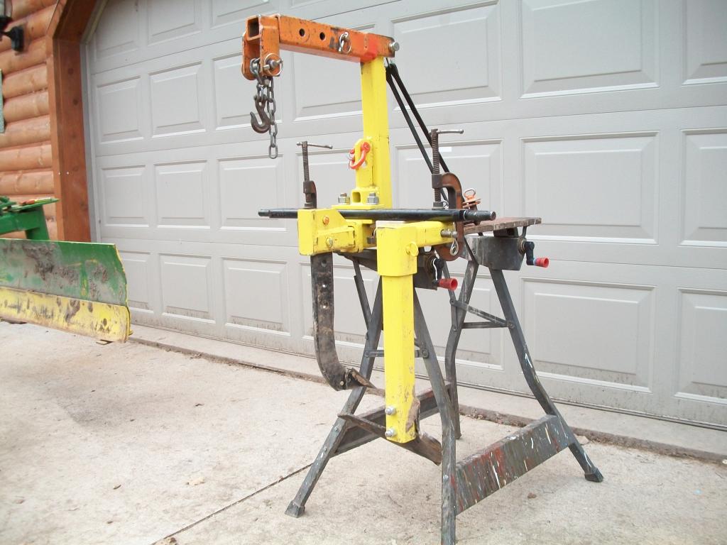

Has a lot of the same features as sixdogs rebuilt sub-soiler, looks just a little bigger and HEAVY DUTY.

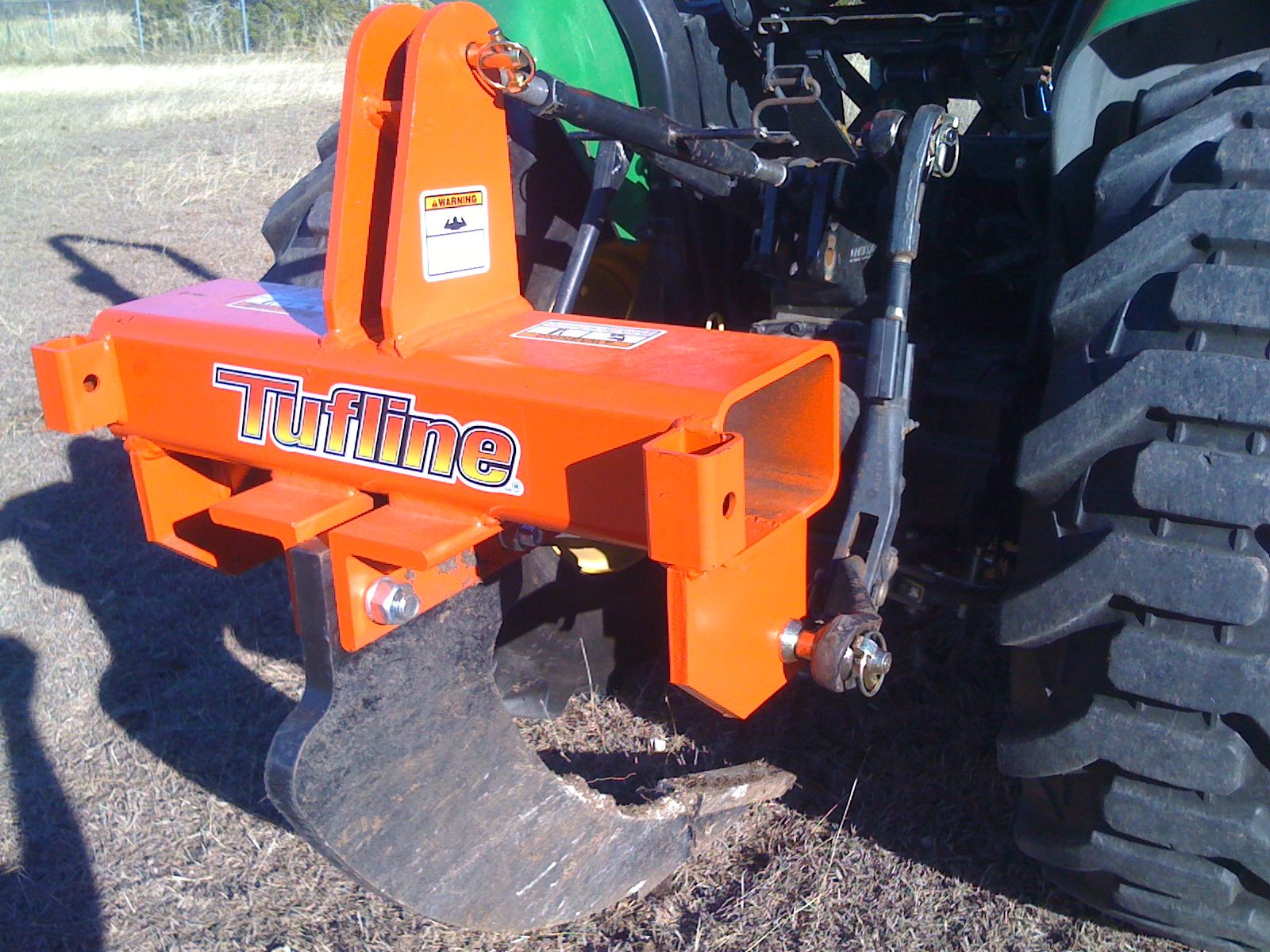

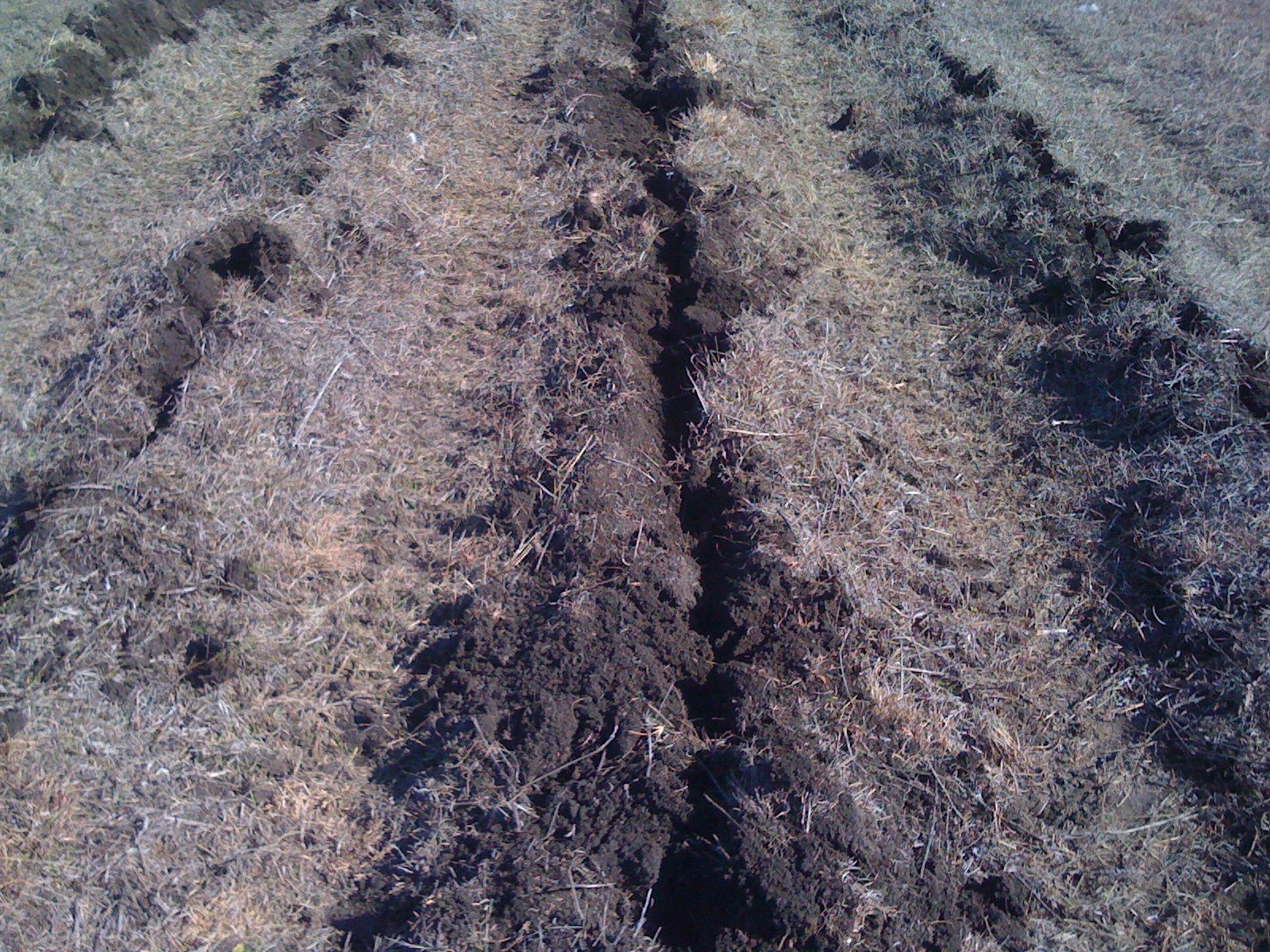

I have a JD 3520 (37hp, around 3700lbs with FEL) and pull the Tufline 24" single shank with lots of effort. I've read that the curved shape of the Tufline sub actually makes it easier to pull through the soil. I can only pull it at max depth in MFWD, and only when the soil condition is optimal. I need more weight. :)

How deep are you going with this and what type of soil do you have?

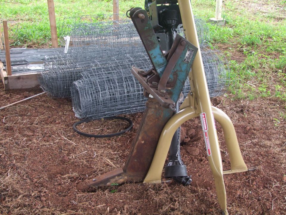

Will the middle buster style tater digger go 18" deep? The ones I have looked at at the local TSC don't look like they would go as deep as an actual sub-soiler is intended to operate.
To Oldnslo....... Yes the middle buster you see in my picture will pull just about full depth, in garden type ground.
