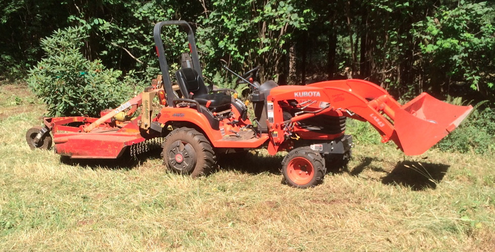

I use a BB48 on my BX2360. Many times when traveling it feels like the front wheels are going to lift off the ground. Probably it would handle better with weight in the bucket. I wouldn't want heavier, but wider would be useful.
Bruce
