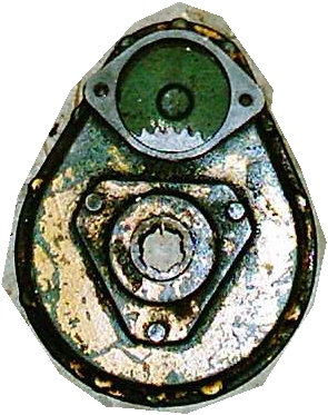

I need to find a pump for the pto bracket or a new pump with bracket . I have looked all over and can't find parts for my long backhoe model 1199A it was made in the USA . I was thinking of buying a pto pump for a different backhoe if I can't find the one made for a long . I hope you guys can help me find the pump that fits the long pto bracket. I sent the pump away and they could not get one they said but I want to make sure because they wanted to sell me a pto pump but the cost is like 3-4 times the cost of a pump.thanks

By bracket I meant gearbox that gears it faster than the PTO speed .I sent the pump away and they could not find one .Here is a pic of the gearbox does it look the same .If it is I would be grateful for any help finding a pump.

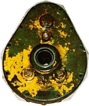

here is the back

Mine doesn't look like that. Yours appears to be steel, mine is cast aluminum and the mounting holes for the pump are spread as wide as the diameter of the drive gear. There are other differences that I won't go into unless you need more detail.

I'm also in need of a hydraulic pump for my long 1199 3 pt hitch backhoe. My hydraulic pump is actuallly OK, it's the larger, yellow, cast iron, gear pump that slides over the pto shaft and onto which the smaller hydraulic pump attaches, i need to replace.
I contacted Cross fluidpower (as suggested above) and they said they dont sell pumps. "and that i might try Cross Mechanics in Kansas". I have not been able to locate them online.

If you care, I have the original specs for this back hoe, as I have one myself. The original pump is listed as 8 gpm, @ 600 rpm, and 2000 psi. it was originally a Vickers 740687 which replaced the 735844. And yes, the Prince pump available from Northern Tool #1051 in their catalog, is a perfect fit for this unit. Just in case anyone else is having this sort of problem.
