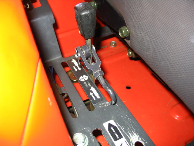

I saw a 3 pt log splitter on the road for $300.. looks in good shape. Guy who has it is just a reseller, No info known. My question is... it has 2 hyd. hoses if I hook them up to the hyd. ports on my M105 kubota, will the hyd. lever on the splitter just work like that, or do I need to bungee the hyd. lever in the cab in the on position? I also have a B21 kubota TLB, what about hooking to its B.H. hyd ports? Thanks for the help. Jack
/ 3 pt log splitter #2
On my M4800 when I hook up to the rear hydraulics I have to bungee the handle in the on position for the fluid to flow to the splitter.
Chris
/ 3 pt log splitter #3
You will have to bungee the handle on the M105, and for your B21 you can hook the splitter to the backhoe ports.
/ 3 pt log splitter #4

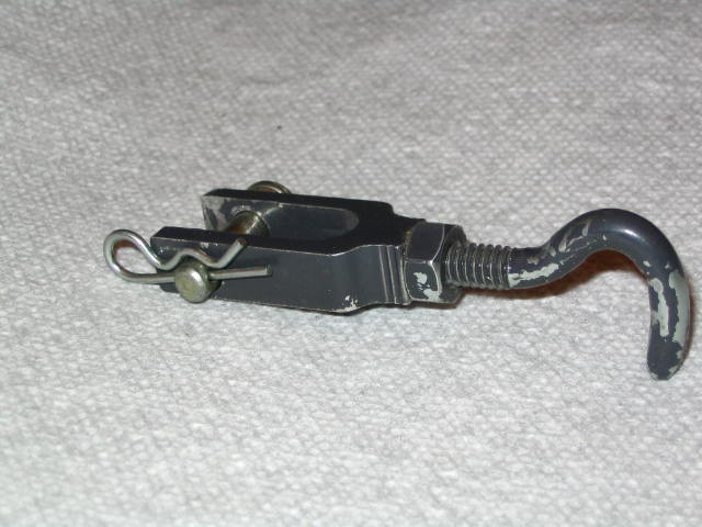

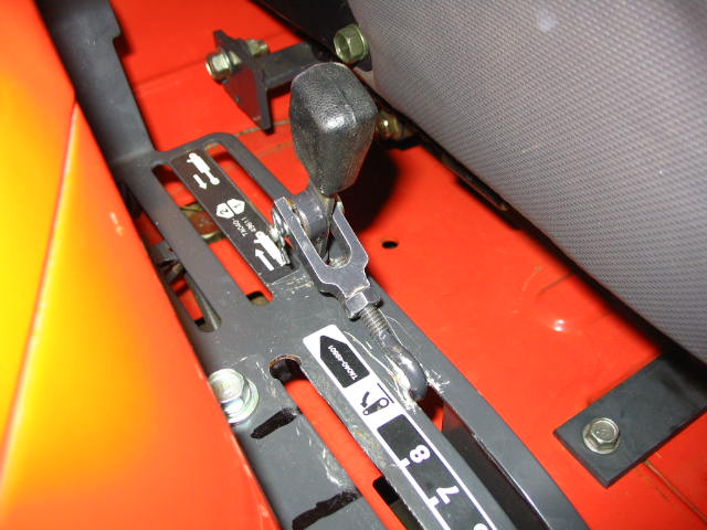

An alternative to the bungee strap thing,is to make up an adapter! I bought an aluminum turn-buckle that I then modified,works great. I use it when my backhoe is on. Will also work with your splitter.
