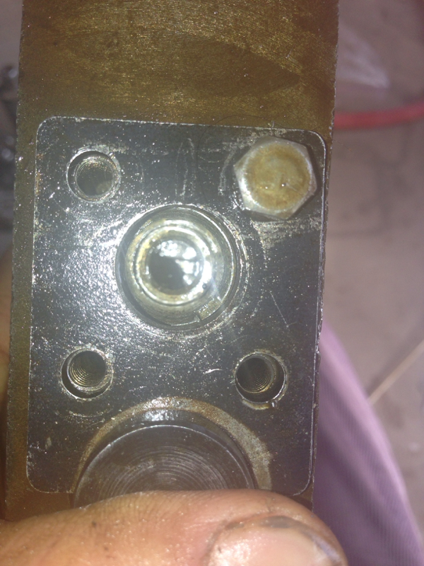

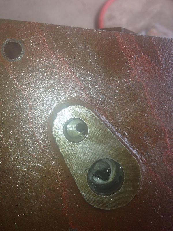

Having some issues with the 3 pt . When the problem occurred I was joking up the front loade, shimmed the pressure valve on the fel to 2k, and filled up the sump too much that to lost a lot of oil through the weep hole or other... Any help would be appreciated
Db
http://youtu.be/E-hstuZfyR8

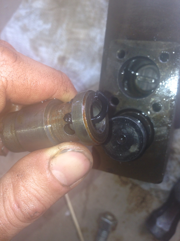

There's an o ring jammed in the distribution or diverter valve

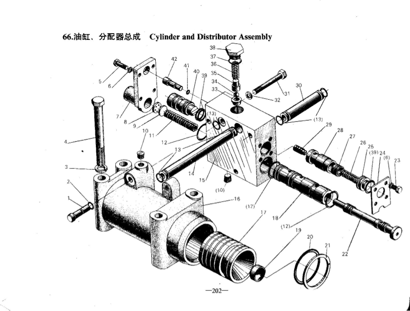

If any one can tell where the o-ring -belongs part -#28 I don't see that small orin
