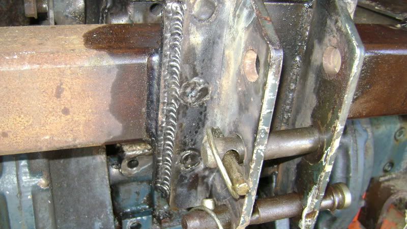

Here are a couple of the pictures, I should have some better ones later in the day or in the am.
welded seam between the top and bottom pieces.
new top link attachment

Great Job welding. Looks great, There is a pivot arm that rotates by the rotation of rockshaft, as the lift piston operates pushes a rod against the arm, I just wondered if you got some weld/slags that block the rockshaft from turning. can you lift the arm manually without anything on the lift arm?

I can lift manually, but I cannot lower it any less than ~12" off the ground.
Pretty sure the push rod and or piston are not connected properly anymore. I am going to try to pull the top of the case tonight if I get the time. That should tell me for sure what it going on.

Thanks to the knowledge base at TBN I was able to fix the tractor last night.
It took some wrenching, some swearing, and some grinding. Got the top case removed, and the piston had come out of the cylinder. Got it put back together at about 10:30 last night, and hooked up a box blade to see if all was working well. I do need a shorter top link, and to reweld the case from where I ground off the original weld.Other than that, I am back in business.
The new top link attachment is not as square as I would have liked it to be, but I guess the ROPS is torqued a little.
Still have a few bolts to tighten down here and there, but for the most part I am done.
Here are some after pictures.

Glad you got things working again. Nice work and nice welds.
