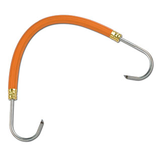

Also, Bailey's (the logging store), and the Sportsman's Guide have had another kind with what looks like a hose in the middle for a grip, and hooks on either end to grab the wood.
These are the midsized ones that run about $22 at Baileys, but I think were on sale at the SG for maybe $17.
Have you tried that type of log grabber? I have one of them. It's OK, but I don't like it as much as my tongs. They just don't seem to grab quite as easily, so I gave up on them. Others may find it works just fine for them.
I bought mine from Bailey's a while ago. I see they've switched brands since I bought mine. Maybe the newer brand works better??
