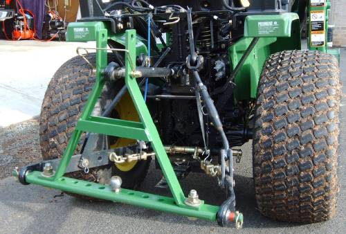

I had a drawbar hitch made. Attached is a picture.
It's basically a drawbar between the 3ph arms that you buy at TSC. I just had some heavy metal straps (also available at TSC) bent to bolt to the sides of the drawbar and formed to make a point to attach the top "leg" of the 3ph.
By attaching another top "leg" on the same pin or an adjacent pin (I had two sets of holes done for the top attachment, because the other held the leg that goes back to the soil ripper that I attach to the drawbar), you can get the same effect as that boom pole thing, but without the stiffness, of course.

Ralphva, that looks pretty nice. You said you had it made for you? How much did the whole thing run you? It looks pretty slick and I like the green paint to match.

Ralph,
I would really like to see how your soil ripper attaches to that drawbar or even better yet.....an action photo. That's a great idea!
