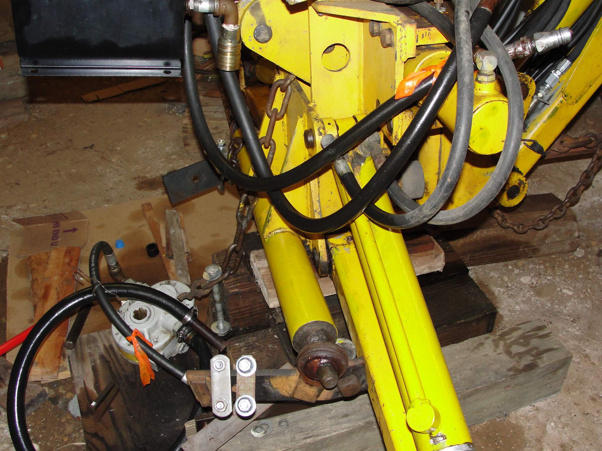

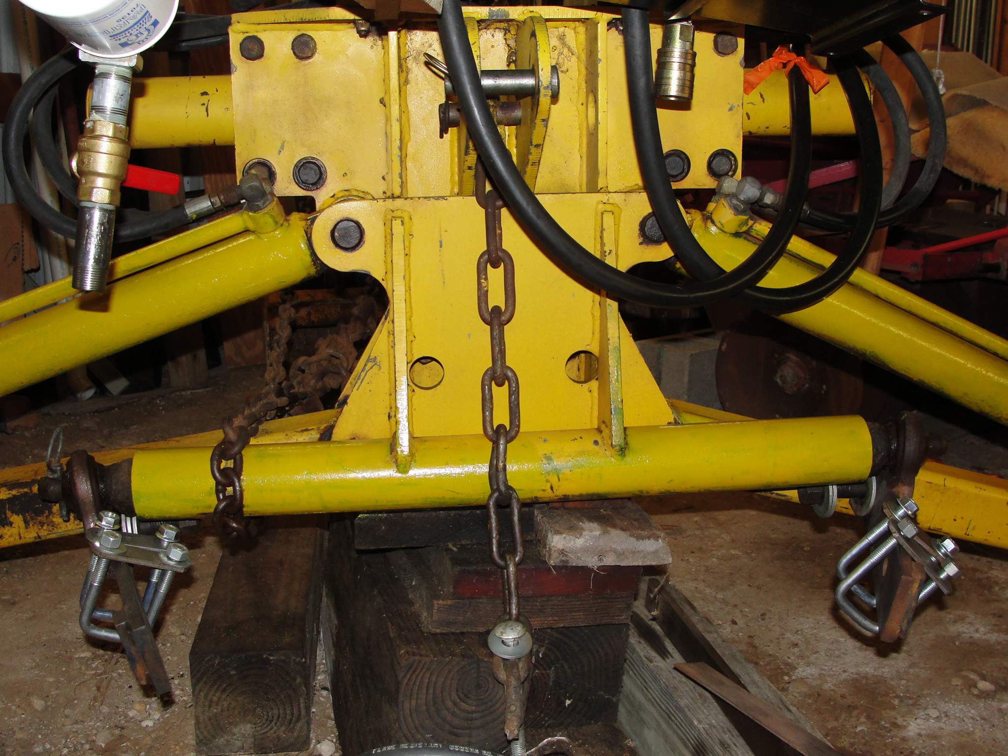

I have had my 3PH back hoe first on my IH-444 (12 years) and the past 13 years on my Kubota L-4610. It goes on quickly either cat 1 or 2. Very importantly is the heavy link chain that you hook down and onto the tractor draw-bar. Once parked in position you use the Hoe's stabilizers to lift the tractors main wheels/ tires clear of the ground. Your Back Hoe lifts the tractor via that heavy logging chain. Most any hoe you see frame mount Case 580s or JD will do the same but with out the need of the chain. This action distributes the load on the 3PH. (Protect the tension on the center link) (The lower lift arms are then relieved of most lifting forces) It seems to me that once something is written on the WEB it takes on a life of its own being repeated and repeated. The guy who "broke his tractor in half" I hope he is on here and can explain how that was accomplished.
Is a "frame mount" better, imo yes. I realize some of the frame mounts are pretty quick to unhitch but a 3PH is also very quick and is also a very viable Back Hoe. All Hoes can put large dynamic forces/ stress on themselves and the tractor. They all will move in reaction to those forces. Those that have actually broken a tractor can do us all a favor and let us know how it was done? Now the guy who actually broke one..... We need YOUR input!
