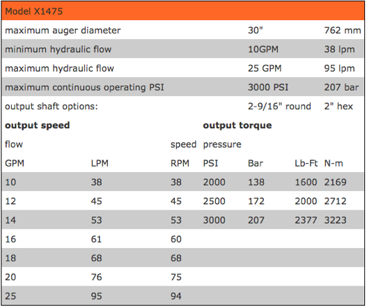

Isn't the hydraulic pressure on a skid steer way higher than on a tractor (or at least one the size of mine...30 hp)?
   / 3 pt. auger/post hole digger #39
Nope, don't have that.
I don't know much about Kioti so can't speak to what pressures the hydraulics are run at.
The M59 hydraulics run 2800-3000 psi ( if memory is correct ) and the KX 80 runs at 4000 and 4500 psi on different circuits. The higher pressures are why the KX 80 will out dig and out lift the M59 even though they are nearly the same hp.
The Mahindra Max 24 runs at 2500 psi ( if memory is correct ).
Skid steer pressures run form 3000 to 4000 depending on equipment size and make.
I run a SSQA hydraulic auger from McMillen model X1475. Here are the operating details at various pressures and hydraulic flows.
There are other hydraulic auger motor manufacturers discussed in TBN but this was one I chose.
   / 3 pt. auger/post hole digger #40
For tractor, skid steer, or excavator its the hydraulic flow. more than PSI to run an implement and second is the PSI range. Most tractors operate 2500-2800 PSI - Skid steers 3500, and excavators 3500-4500 - the higher pressure will lift/dig more, the higher flow will run implements like snow blowers, PHD, stump grinders on skid steers, and mulchers etc on excavators.
