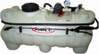

I purchased a 25 gallon Fimco tank/sprayer from Agri-Supply and mounted it on a home built 3pt carry-all. I wired the 12v pump to a trailer hitch plug I attached onto the aux light circuit. I can use either the spray wand while sitting on the tractor or divert the flow to a boom.

Right now I have the sprayer stored away for the winter in the garage and the carry-all out in the Cover-it shelter. The carry-all is typical of one you can buy almost anywhere, I just made my own. I have attached a pic of the Fimco sprayer without the boom. Btw, the sprayer was $150 + shipping from Agri-Supply.

Mad. . . That sprayer unit you showed looks just the 2 I ordered from Northern.
I ordered the tree sprayer head instead of the wand type sprayer yours has. The tree sprayer head is supposed to be good for spraying 35' up into fruit trees and such (but I would be happy if it sprayed 20+ feet). I think I got 30' of hose (I'd have to check my notes but they'er not in front of me now) for each sprayer. I needed the higher capacity pump for the tree sprayer head as well. The units I ordered were $269 each the way I spec'd them. They had a 1 year warrenty, I bought an extra year for another $24.95.
