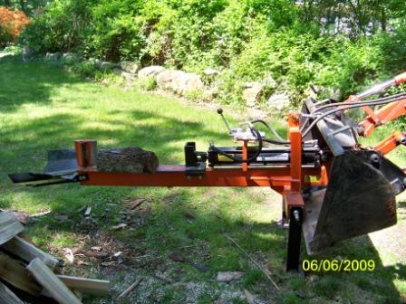

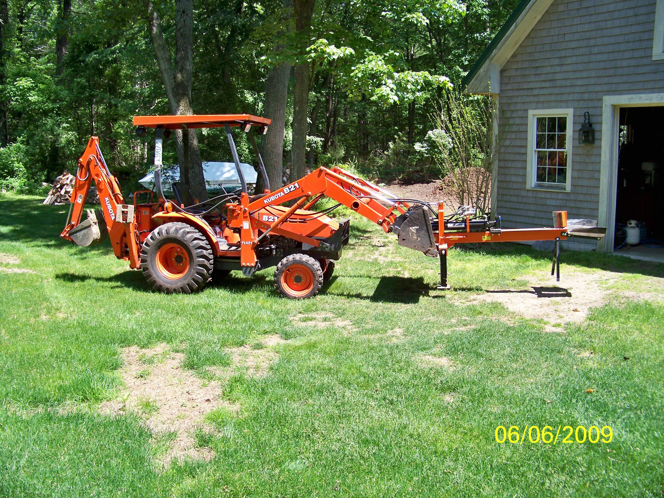

Hi Glenn,
Just wanted to share a photo of the setup I use. Its a 3PT splitter on the front of my B21 with hoses running to the BH connections.
I pin the BH in place and remove the lines and connect the splitter - takes about 3 minutes to hook up and be running.
I can also remove the front leg on the splitter and drop it close to the ground for those big rounds.
The last benefit is I leave the splitter attached to the front then reconnect the BH, then with the thumb lift and cut 2 or 3 log lengths then turn around and split again.
Carl,
Thanks for sharing your fotos n idea, interesting......
I too want to add a thumb to my Kub for help moving n holding up long logs as I nip um into rounds. Glad to know it works n is a practical idea.
Do you mind me asking a few questions? (hope not).
I am still concerned how powerful my HST L28oo Kub will operate the 3 point hitch splitter I am planning to buy. Are you happy with how fast n strong your splitter operates using your Kub's hydraulic pump?
My Kub is said to only have 2250 PSI at 6.5 GPM. Do you know what your Kub is rated at and how happy are you with it's power n ram speed. Also what type of wood are you generally splitting in your area? Is it hard wood or soft wood?
Thanks, Glennnnnnn
   / 3 point Splitter on L28OO HST compatibility #20
Hi Glennnnn,
The B21 has two hydraulic pumps - one for the Loader/BH and one for the power steering.
The rated flow is 8.5 GPM for the Loader/BH and 4.5 for the PS total 13 GPM.
I run about 13-1400 RPM when splitting and its a 4"x24" Cylinder and cycle time is comfortable about 20 sec total - the cycle time doesnt change too much if I raise the RPM as its flow mostly not pressure.
I have the auto detent retract, but usually I have the next piece to be split on the rail by the time it retracts 18" then I cycle forward again. (dont take the full 24" stroke)
As for wood, all hardwood typical is knotty maple, red oak, black birch. Large rounds 20" plus are no issue nor are the "crotches" of trees when splitting against the grain.
I would say for your 6.5 GPM it will be OK, but maybe get the 3.5" x24 cylinder - less volume and more speed - should work out fine for you.
Carl
