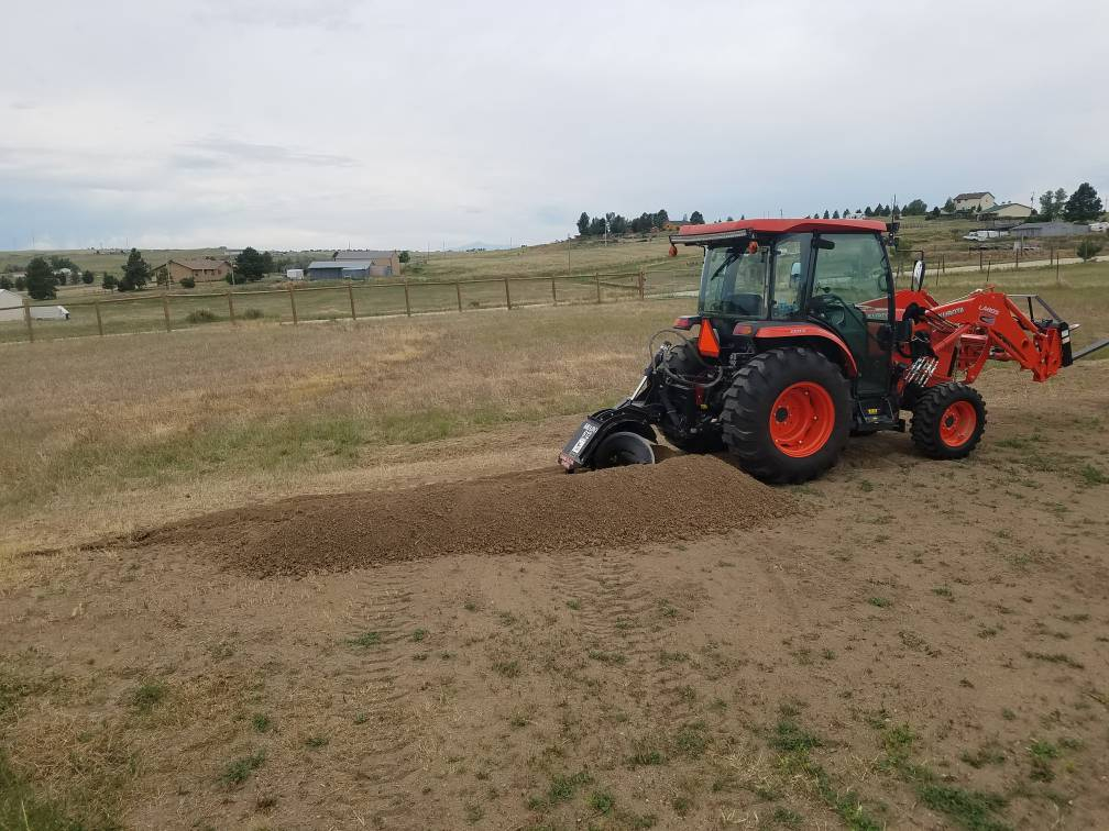

I have a Bradco 3pt trencher I got for pretty cheep off Craigslist a few years ago. It will do 3' deep. Slow going in my hard clay, but we really don't have rocks or roots. I have HST+ & can creep along at a few yards per minute. I'm barely able to go slow enough & am not sure a normal HST could go slow enough. I know a geared machine couldn't go slow enough unless you had some special creeper gear you really don't find on CUTs.

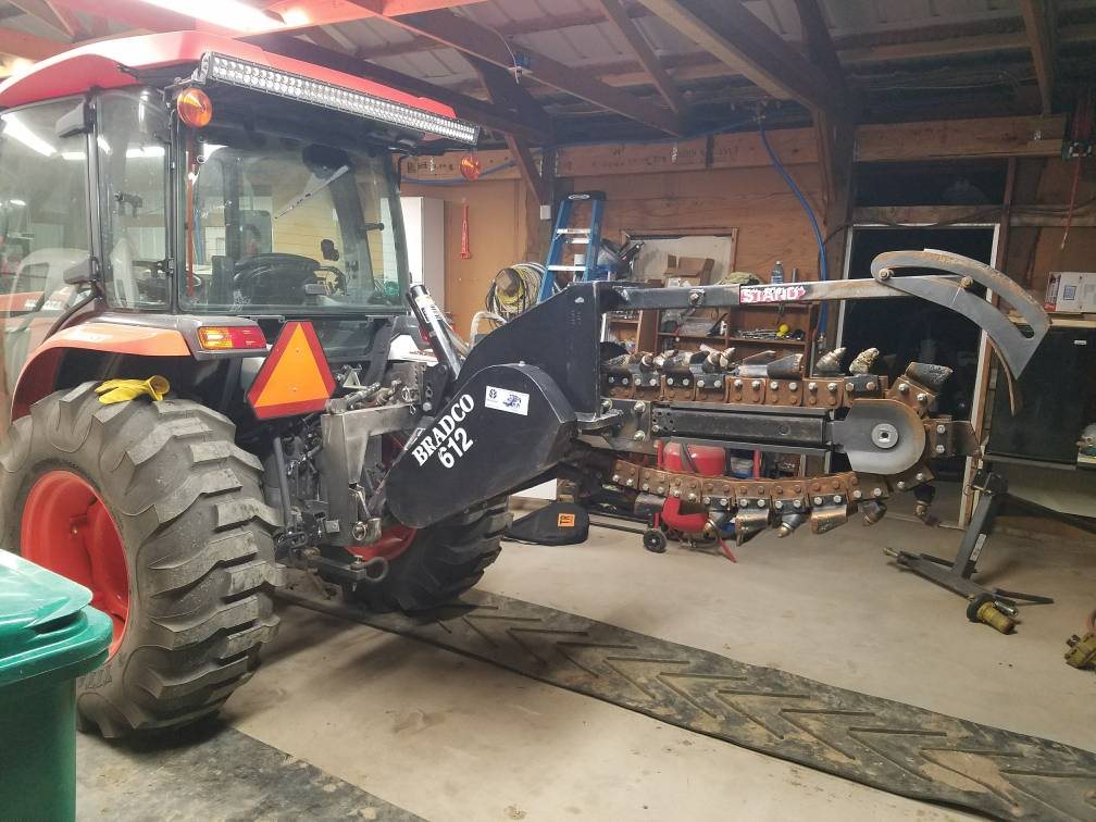

Other photo that didn't attach right.View attachment 765994
Fallon,
What is your opinion of the Bradco 612 3pt trencher? I see you running the rock/frost chain on yours in above picture.
I was seriously considering one two years ago, before prices went absolutely ludicrous, but did not pull trigger on the quote for use in the rocky ground of western NC. I was looking at the 48" depth model with two chains. Dirt with skip every station and a rock/frost chain.
I am returning to looking for a 48" trencher.
/ 3 Point PTO Trencher #16
Fallon,
I think I paid $2k for it 4 odd years ago. Propane company was getting rid of it. To big for small stuff & not optimized for big stuff from what I could tell. They only needed 18" & a walk behind unit for putting in residential propane tanks. Came with a spare drive gear & I think they said the chain was new. Haven't paid attention to the teeth in years. But I'm low use & wouldn't wear most anything out.
Could probably sell it for more than I paid for it these days. My ISP had been parking up to 20 rigs (directional boring, mini-ex, vac truck, cable plow) in my pasture this summer. So I'm in good with them & have access to better gear to some degree. Haven't thought to much about selling off my trencher though.
It's worked fine for some projects on my 5 acres in hard clay. Not enough for real work, but plenty fine for somebody with occasional needs & a CUT.
Frost line here in the Denver area is 36-48". So at 36" it's sketchy if this is deep enough for water line. I haven't risked it, but all my projects have been power or data lines.
Trenching is digging & I'm not insured for digging in my side gig (mostly mowing, driveway maintnance & snow). So the trencher is personal use only. Digging takes insurance from $1,600 a year for landscaping to $8k a year or something.
