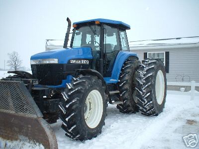

heres a set i made for the back of my ford 8000, i used forks and carraige from a junk forklift, i have moved cars around with them with a set of extensions on them, they handle alot more than 3000 lbs, i think your best bet is to make or have someone make a setup like this

Markct: I believe what you have is what I'm looking for. I will start looking in the junk yard for a set of forks. Thanks for the help.

wvbartman, where ya from, it doesnt say on your profile, if your nearby i may be able to build a simular set, altho there realy not that hard to make if you have a large drill press or milling machine and a welder, i actualy bored the holes on our horizontal milling machine since our drill press is a bit light for heavy drilling. the forks have held up great tho to all the abuse my tractor could dish out, i often use fork extensions made from 8 inch channel that are around 8ft long to move larger stuff like sheds, and last weekend i used them to move a slide in truck camper, that realy made the front end light but the forks held up fine, i use them with my homemade hyd toplink usualy which is a huge help, makes it easier to get under stuff and to dump stuff off the forks
