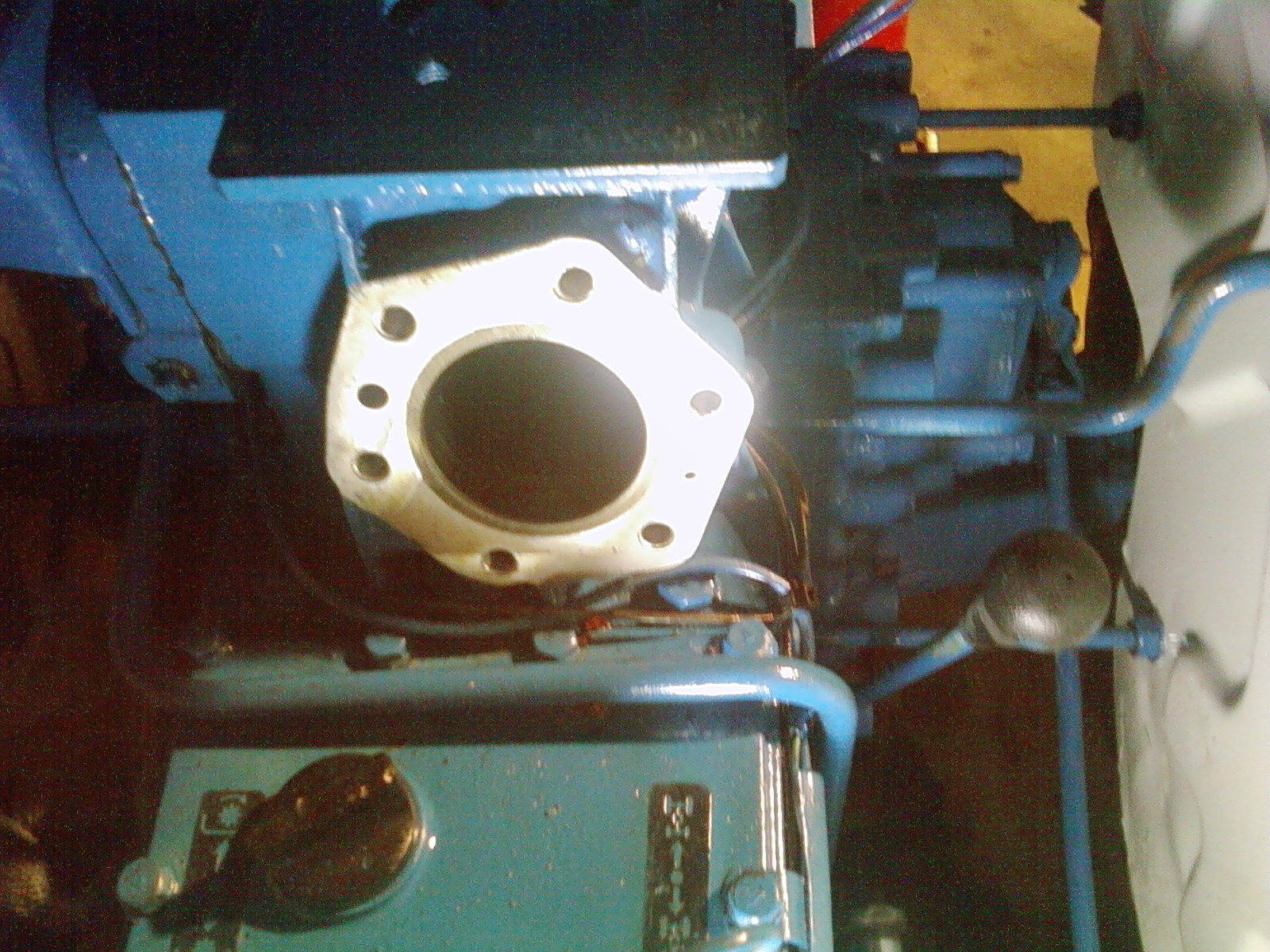

0417121752-00.jpg0417121753-00.jpgNo internal pump I know of. Here's the deal: Its probably a bad seal on the lift cylinder, but could also be the pressure relief valve or the lever sensor valves. Was your old fluid black?
   / 3-point is jumping up and down #7
no old oil was ''greyish'' but is like that every time we check it or change it.. tractor is barn kept so not out in the weather..
Will check cylinder lift as have not done that.. Where would we find pressure relief valve or the other valve.. have good mechanic but with little "Long knowledge''... Thanks !!
   / 3-point is jumping up and down #8
The pictures show a Ford, but I imagine a Long of that vintage would apply the KISS logic and locate it right near where the position control lever is and where the high line enters the contol valve. On Fords its on the right-hand side of the cylinder. Usually, 6-10 bolts will get you a look-see at the cylinder and seal.
