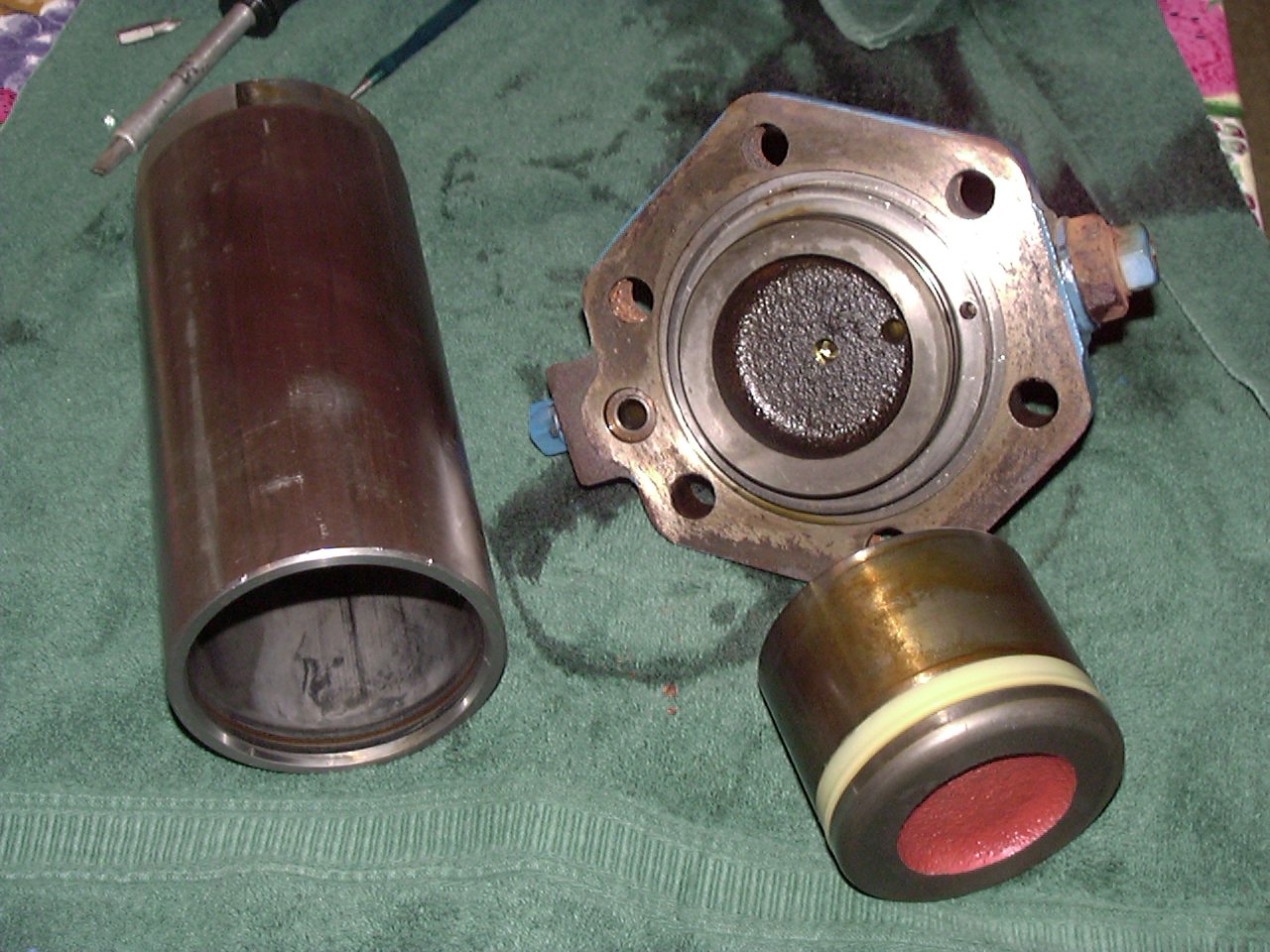

Yea JC, its a 2 wheel drive so any rim I find close should work. That 6 lug bolt pattern is odd though and I havent found any yet, other than the factory replacement part which costs around 160.00 each, ouch! Just for giggles here's a picture of the condition of my piston seal.....lol
Wow it's amazing.Mine looked a heck of a lot better,:D lol
JC,
Ps. One good thing is that the same exact piston seal is used on several newer NH TC, series as well, can not remember exactly which one, so future availability is of no concern.
/ 3 point hitch won't lift #94
lol, well I have abused mine slightly. My 5 foot box blade is way to heavy for this tractor. And the 5 ft brush hog is pretty heayy too. It pulls those attachments no problem when they are on the ground, but when lifting the box blade it strains the hydraulics. The brush hog doesnt really strain it that much, its just a long attachment and it gets alittle bouncy. I'll be hooking the brush hog this weekend and see how the new seal works.
