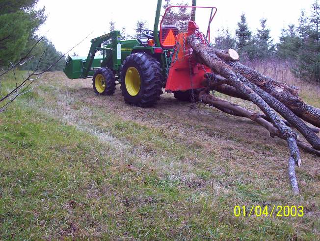

/ 3-Point Hitch Skidder attachment #25
Stopped on a pretty steep hill. 3ph up as far as it will go (normally not), bucket off the ground. No loaded tires or extra weight in bucket.
Started going again with(out) - herr, herr - a hitch.
Made sure I started off smooth - no front end lift.
Wrong date on pic.

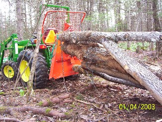

/ 3-Point Hitch Skidder attachment #26
No. 2 Heading homne to supparr!

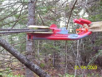

No. 3
Self opening snatch block

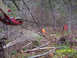

No 4.
Snatch block in action. Pulling the small stick under orange sweatshirt towards the block. Can pull it all the way to block or enough so as to hook and pull other end of stick to tractor.
