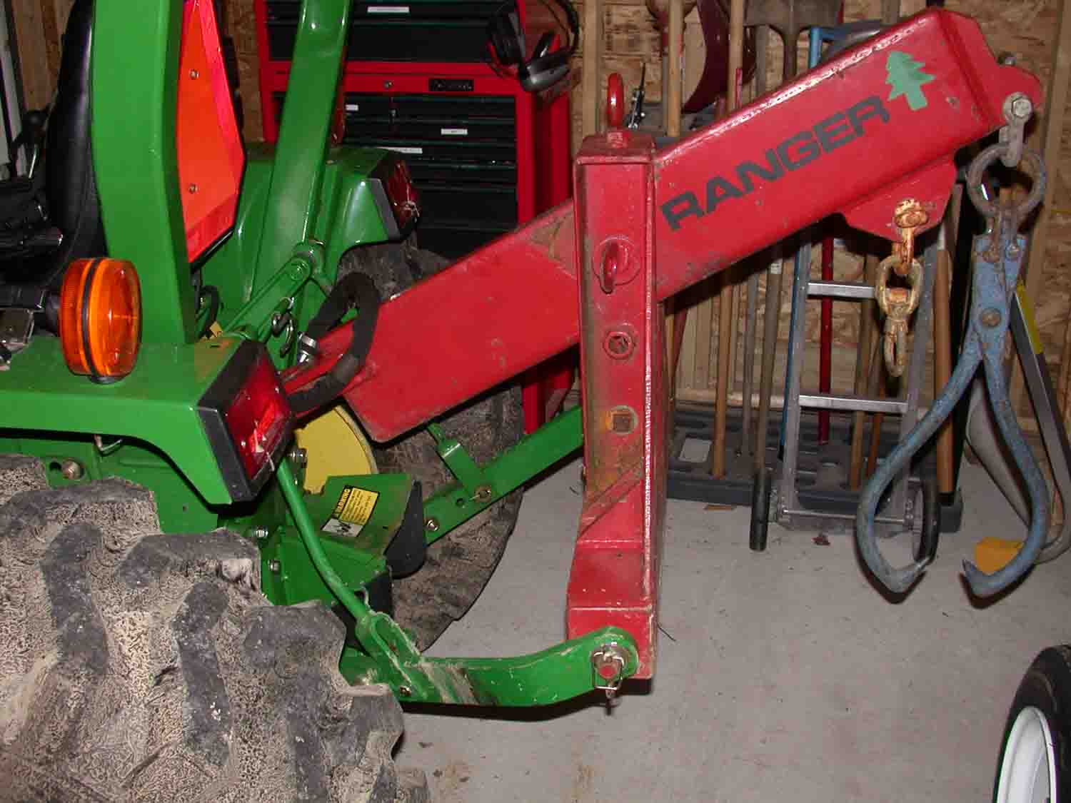

The tongs with the upward pointing points are lifting tongs, and are more likely to have a welded ring. The ones with sideways pointing points are skidding tongs and are more likely to have a chain hook. You can get it the other way if you want.
