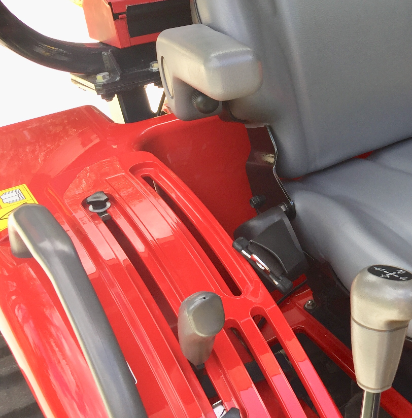

I have the RK37 HST cab model that I purchased in early late June or early July. I have about 17 hours on it now from pasture mowing but I've noticed something that I'm not sure if it's an issue or not. The 3 point hitch control lever marking are from 1 to something like 9 with 9 being the lowest position. That seems backwards to me. But the question I have that maybe another owner can let me know if theirs is the same, my hitch doesn't start to raise until I have the lever about 65 to 70% off the lowest position. I have an old Case tractor and the hitch on it starts raising almost the instant the lever comes off the lowest position. If RKTractor guy happens to read this maybe he can make a suggestion to have some type of stop added so that once you get the correct hitch level set you can set the stop so that if you have to raise the attachment to cross over a road or something you only have to lower the level back to the stop for it to be right where you want it.
Thanks....Don

OK, on to the topic. Just for reference, my Massey 1532 3-point doesn't start to lift until about halfway through the lever's travel. Well, it may be moving the lifting arms before that but you don't see movement in the mowing deck until about 50% stick travel.
Additionally, the Massey has two adjustable stops, one below and one above the lever. You can see them in the pic below. I'm not familiar with the geometry of the fairing around the RK37 lifting lever, but you may be able to make some of your own stops pretty easily with a short bolt, some large washers, and a wing nut. Heck, the ones for the Massey may even work. I could take some measurements if you want.

Thanks to everybody for the replies and suggestions. I looked at te 3 point lever briefly this afternoon and it appears that g8erh8er was onto something with making something of my own design. It looks like a small carriage bolt would be perfect it I can get to the slot from the bottom. The square portion of the bolt would ride in the slot and prevent it from turning when tightening the wingnut. RTBee, you say that your RK55 has a stop. That's what I'm looking for. Something to stop the lever at the lowered position that I want. Now, if I raise the mower to cross over an area I have to fiddle with the lever a couple minutes to get it back to where I wan it set again. If there were a stop that I could set I could just lower the lever until it hits the stop and the mower would be at the correct height. Maybe I need to go back and look at a RK55 and another 37 just to make sure that I don't have something missing. oosik, I agree that it doesn't make a lot of difference as to when the arms start lifting but if yours start at 25% from the lowest level and mine don't start until 65 - 70% from the bottom there has to be something between the two machines. I'm not sure I'm getting the full lift on the arms. That's why I mentioned before of measuring the distance from the ground to the bottom of the arms at full lift. I'll do that this weekend. Have a great week......Don

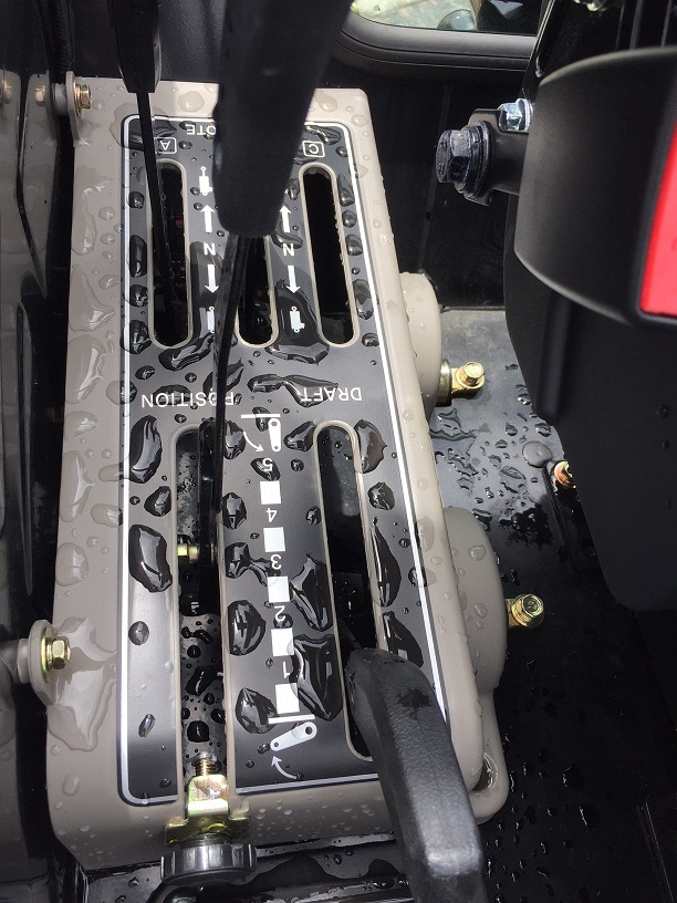

Don - carriage bolt sounds like a great idea. FYI, assuming your cab model utilizes the same fairing under the protective cloth as the open cab RK37, the depth lever has a much wider slot (see below). Looks to be plenty of room to work the bolt down into that side and then back up the position lever slot.
I've also attached a pic of the RK55 setup. You can see the stop shown at the bottom of the pic. I bet you could buy that stop and modify it to fit.
