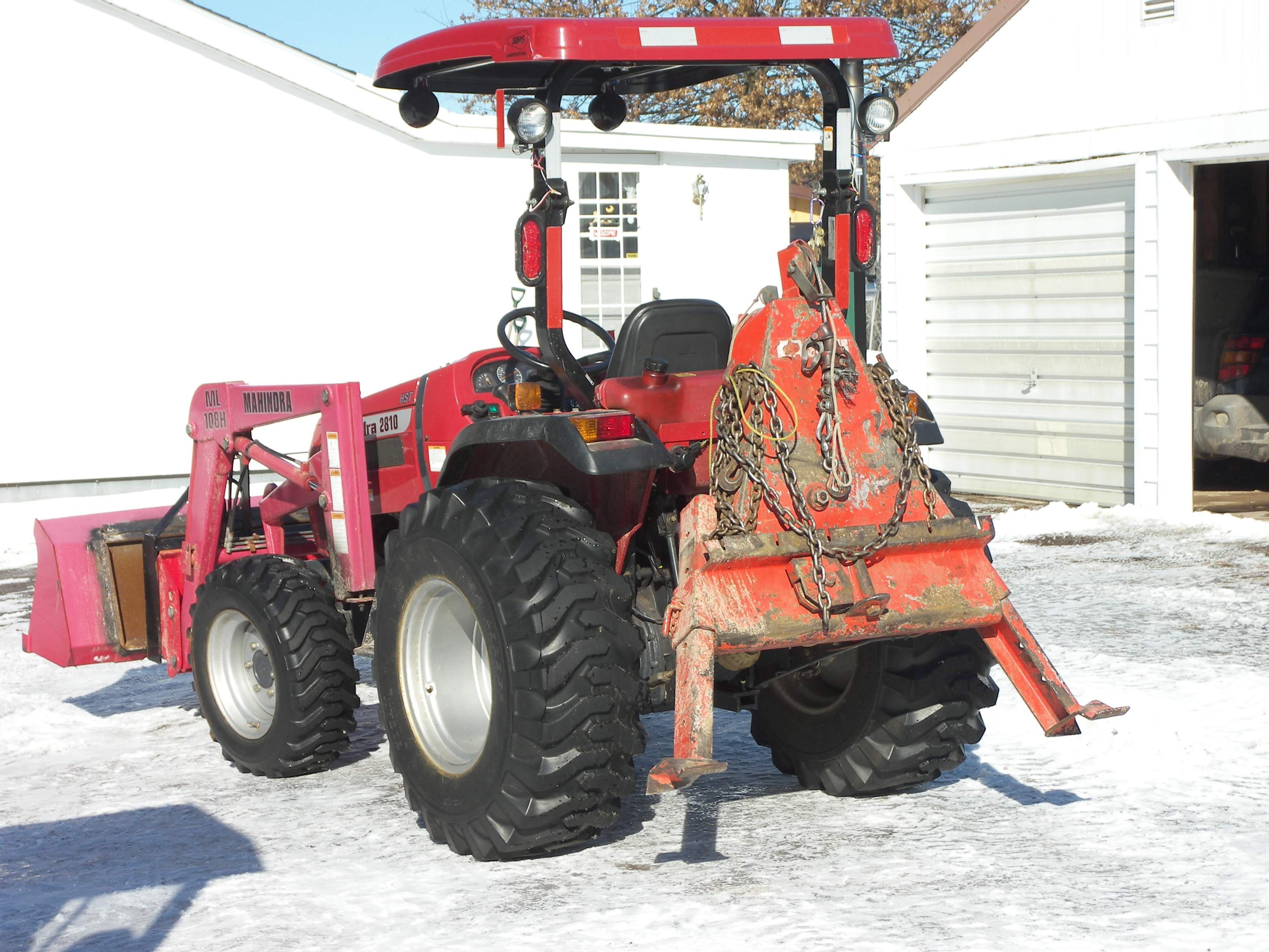

Piston. . . .I understand what you are saying because i was in the same way. It was something i wanted. I have a farmi winch and thought about repalcing it with a grapple because face it a winch is hard on your tractor, i know last April i broke the rear end housing on one of my tractors, its repaired and all is for the better. My land is in places very rough and rocky, hilly and some really deep muddy holes all which is where my good wood is located. I almost pulled the trigger on a grapple which was going to be the Wallenstein LX5100
Log Grapple but decided to stay with the Farmi winch, it serves my purpose well and owes me nothing . . .John

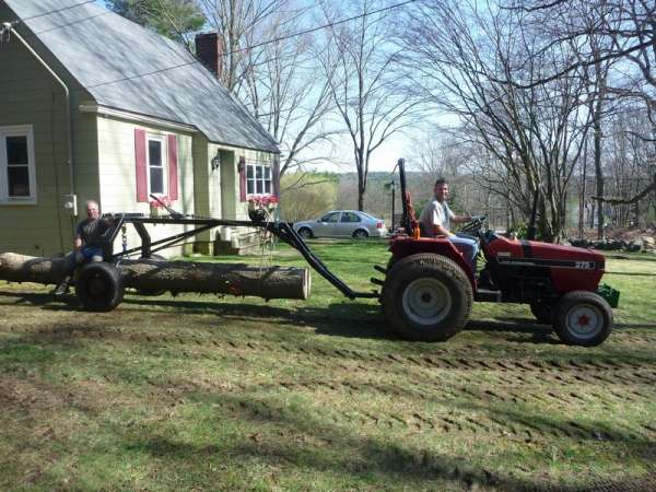

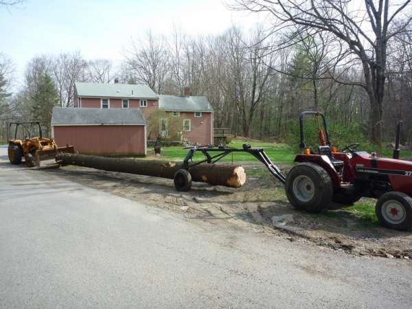

I forget who said it, but I remember reading from someone on here that the less you have to get off the tractor, the better.....and I fully agree with that statement :laughing: Try hooking up a logging winch or log arch without getting off the tractor.
Here is a pic of the log arch I built. It works great, but the few minutes of setup time it takes per log, really adds up at the end of a day.
The grapple skidder is simple, back up, grab on, and go. That's the point of a one.

Here are a couple pics of the log arch I built.
