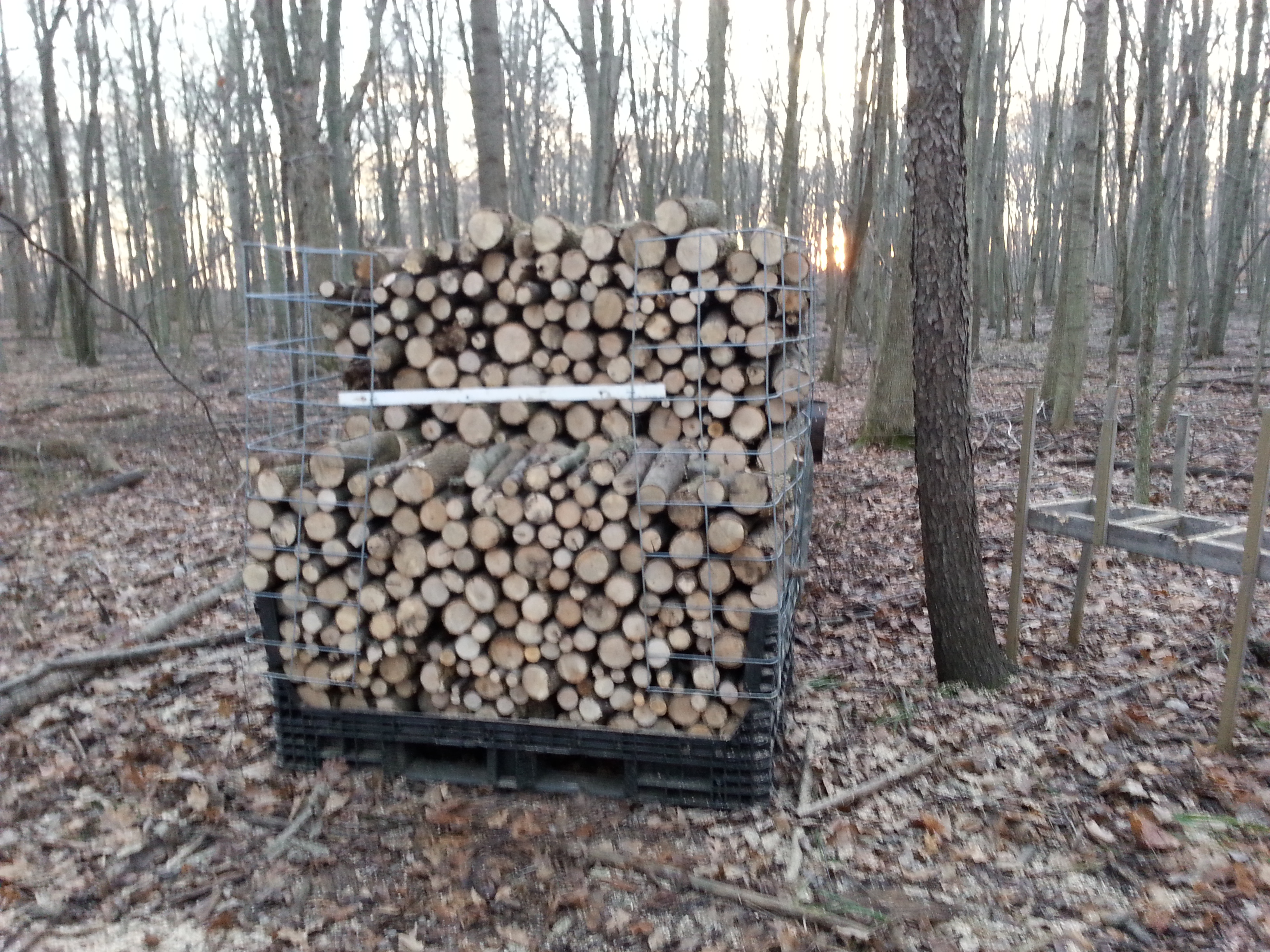

i have a kubota B 2630 model . I have never used a 3 point hitch on mine but was planning on building a box to use on the 3 point hitch for when cutting firewood . How much weight can a 3point hitch lift including a box I make for it .

Somewhere around a ton depending on how you have it loaded. On my 1710 I can haul about 3/4 cord of hardwood when it is under 20% moisture. Here is a photo of my "box". It is 48 x 64 at the base.

Search engines and owners manuals are your friends! A real quick online search turned up 2139 lbs at the ends of the arms, and 1676 lbs 24"out.
   / 3 point hitch loads #5
Also reveals that tractor weighs 1786lbs. So OP may want some front end weights if he loads a near ton on the 3 pth. Front end may get a tad light otherwise.

Thanks everyone for responding , plan is box big enough for about 1/2 cord of spruce / junipter or dry spruce so I should be save with that. I have a loader bucket on front of tractor so should be ok with the counter weight .

Yeah, no way that tractor will carry a ton without front weights. Either the front tires are in the air or the box is in the air, but never both. :)
whooppss. Should have read down. Yes, with an FEL and possibly weight in the bucket you might pull it off. Or carry it off. :)
