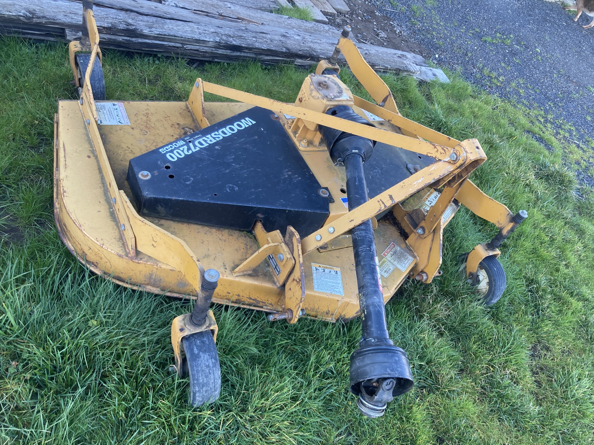

The only reason for a top link on a mower is to raise it off the ground. The top link should not be fixed when mowing. In fact, you'd be better off just removing the top link when mowing to allow for uneven ground. The photo below is how most mowers are made for the top link to flex to allow for uneven ground.
