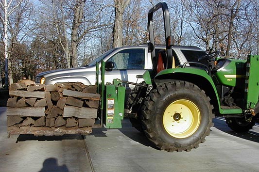

I started a thread on this in the general forums but didn't get much response, so I'll share it with fellow JD owners here.
For those with quick tach forks for FEL's, this may be something handy for moving palletized materials around yard/barn/shop. provided you don't have to raise pallets over 18 inches, this is a very quick way to move pallets, very easy to see and engage (unlike loader mounted) steadier lifting and no leveling.
I really didn't give this much thought or engineering, so I'm sure some one could come up with a better/easier way, but this ain't to bad just the way it is, at first I thought just an alternative to a carry all but now I think this might have a higher capacity than when mounted on a loader?
I got the idea from seeing Kubota with rear forks on a construction site. My forks are from Horst MFG. $20.00 in material, 1-1/2" and 1-1/4" solid bar, misc steel pcs, and welding rods, about 4 hours work.

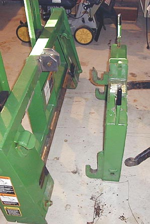

The finished product looks great. In my 790 thread we were talking about the beefed up bulk head on my new Horst pallet forks. After studying the photos I noticed on my forks the attachment hook is welded to the beefed up bulk head and so the top attachment pin is also welded higher on the forks. Your hook and pin are welded on lower. My forks also have the lower pin. Probably because your loader is a 300cx and mine is a 300.
Thanks Everyone, dirt ditch, I think the reason for the new style fork attachment is because it will probably fit on a larger loader using the lower pin. I don't think there is a difference between the 300 and 300cx probably even the 200 series have the same carrier, the larger loader (400 maybe) must have a larger/longer carrier, that way the mfger only has to make one model for many loaders. That's my best guess.

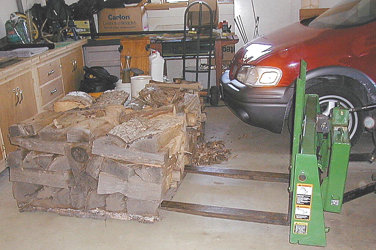

They are very handy to have, and especially handy with HTL. I move all my firewood on pallets from storage into the garage with the forks on the iMatch. Not much additional iron to make them iMatch compatible.

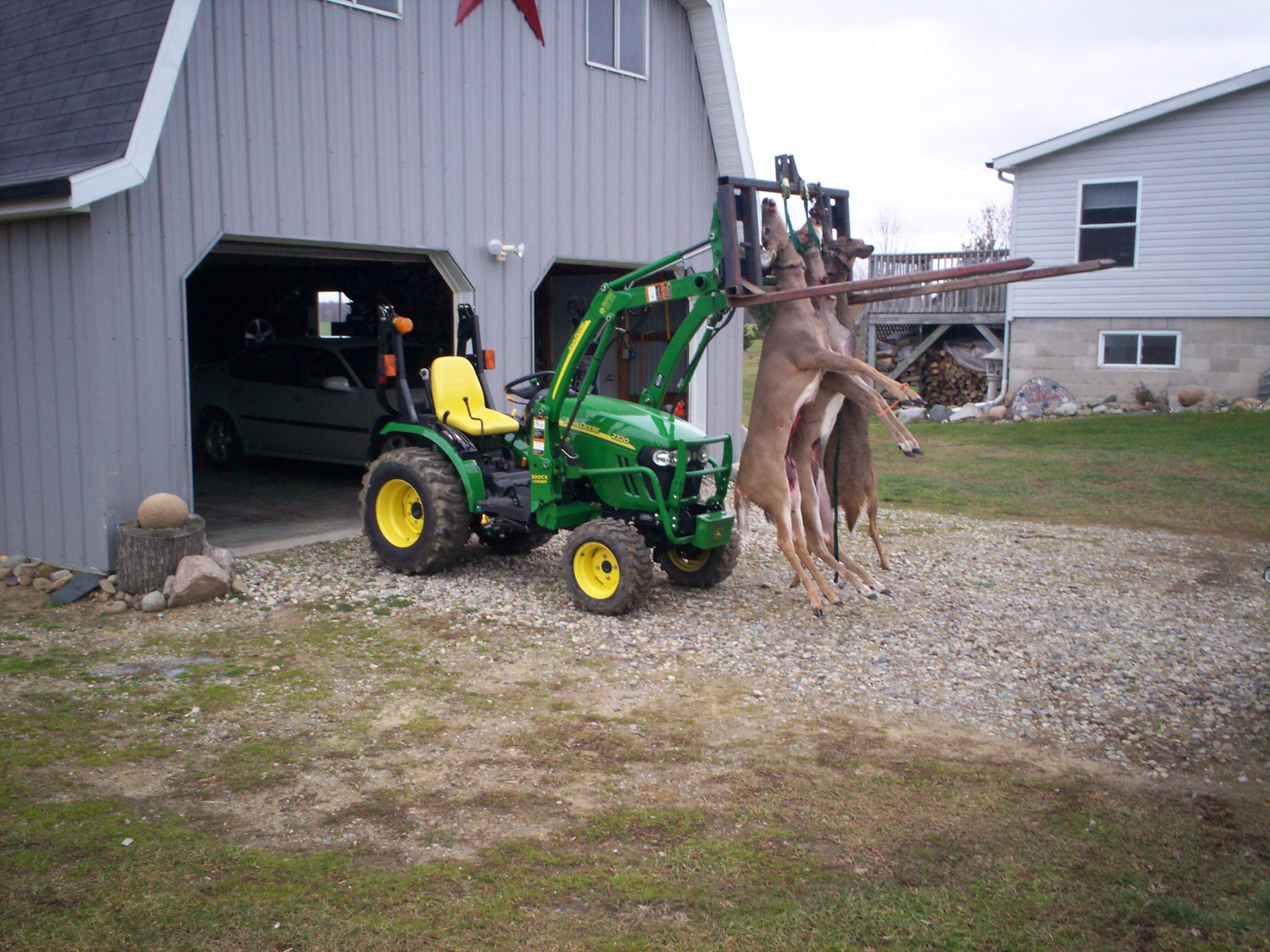

Another thing guys can do also is buy an old three point round bale mover and add the quick tach pieces for the loader. I was able to do this and got the pieces for about $40 from Deere. The only problem is the forks are not adjustable side to side but the tines are nice and long to accomodate sliding underneath large round bales. Heres a pick of mine. I can also still use these on the three point.
Don't see no ''large round bales'' in that picture.:D
