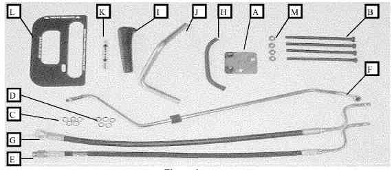

Since you already have the Front Hitch with Power Angle, you will also need 759-3971 service kit for the fourth handle. You will have to cut a hole in the fender and drill some holes in the frame to mount it.;)

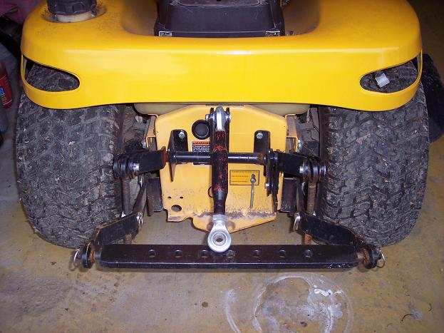

As far as what one looks like.:D This is a 190-365 hitch; yours will be a 190-207.

Peavs, how do you like it? Is it worth the $900, would you do it again? My dealer is not real keen on putting one on mine because of the mods to the fender and frame and the addition of the 4th valve. Do you use any other implemets on the back other than the tiller? Just curious before I drop that amount of $$.

Fortunatly, I found mine on eBay for alot less than MSRP. I also got the tiller (never used) for a whole lot less :cool: than MSRP off of eBay. I don't know if I would have bought both otherwise. It took almost a year :eek: (after I got the tiller) for a 3 point to pop-up (and then 3 became available in about three months). If the dealer is not going to install it, then I would try to knock the price down. I think that dealer cost is around $600 - $700 for the kit. Installation is no more difficult than the front hitch except for cutting the fender. Thats not too hard if you take your time and have a Dremel.:)
I would like to find a good (cheap, because I'm cheap) box blade and/or back scraper blade to play with, but have not found one yet.
