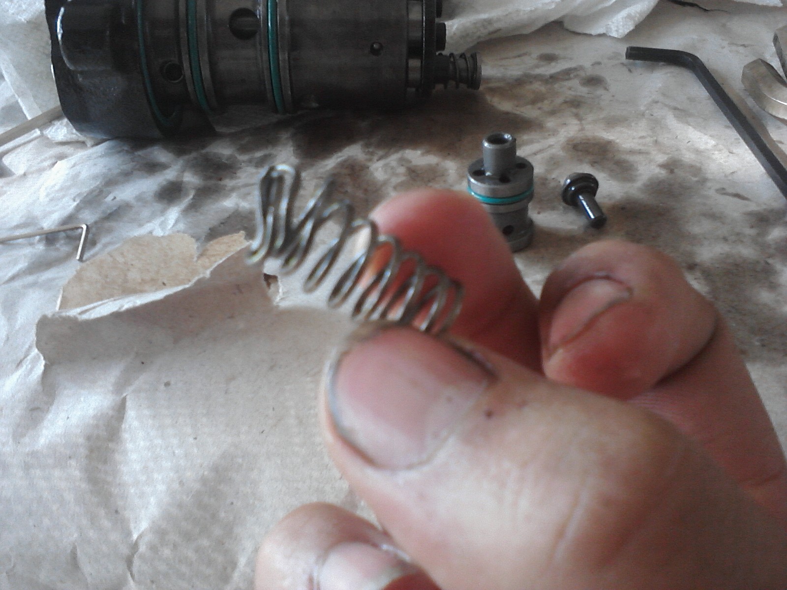

The only issues I had, that was not dealer related, was the MLS valve on one unit. 3 pt bounced like crazy when trying to raise. I removed the MLS valve myself, and through the side of the assembly I could visibly see a check valve needle that was seated sideways in its slot. I popped it and the spring out, seated them properly, though the spring was a little wonky, and all was fine. 3pt worked as advertised. I mentioned this to the dealer, with photos, to see if I could just get a new spring in case the current one failed, and they exchanged the "fixed by me" MLS valve for a whole new one, no more questions asked. ($900 part)
