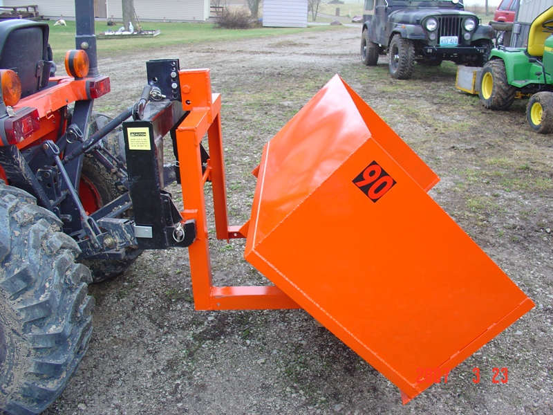

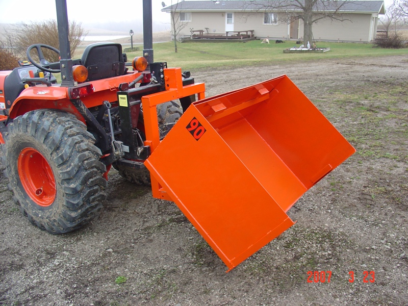

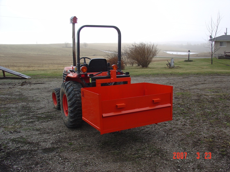

I built mine. Have no idea how much it cost me. I was more concerned about building something that would take a beating. This one works for me.
Sorry I don't have plans, just made it up as I went along.

   / 3 point carry all, build or buy? #7
Looks great!! how do you keep the tilt bed from staying tilted ? Do you have a pin or something to keep it horizontal during transport?
Jc,
   / 3 point carry all, build or buy? #8
ovrszd,
As shown in the second picture, that's the oddest exhaust stack I have ever seen.:D
Seriously, Great looking project!
   / 3 point carry all, build or buy? #9
I wonder how he keeps the white specks off the hood :eek: Kinda like bird huntin from the tractor seat :D :D
