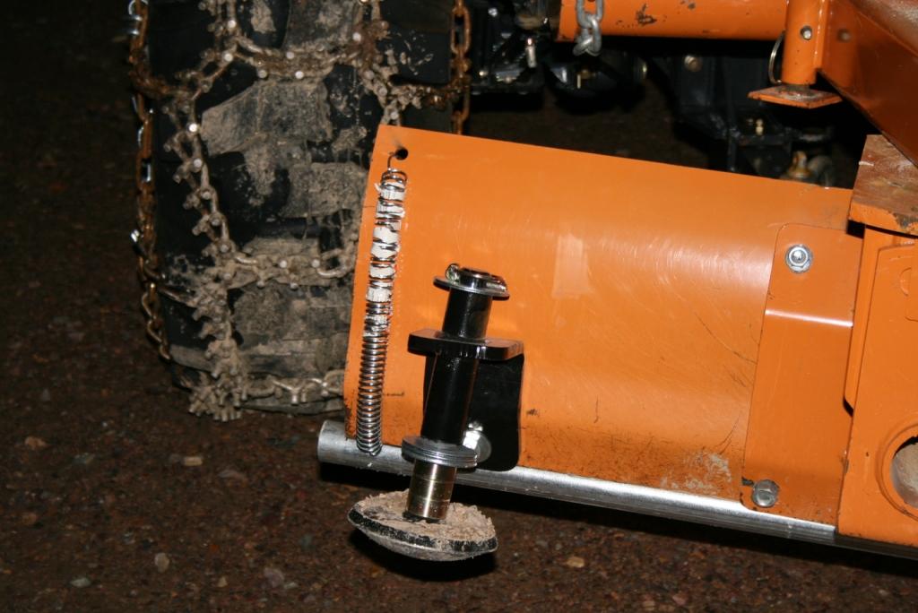

I bought 2 small chisel spike teeth. Welded a piece of angle steel to the middle of them and bolted them to the corners of my box blade. With the curved shape of the teeth they glide over the ground going forward or backward. They leave about 1 inch of snow but I don't have any problems with relocating gravel.

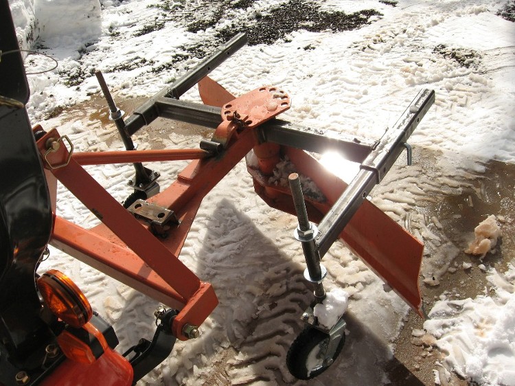

These have been working great for my bx23. On the shop apron I set the wheels so the blade is 1 1/2" +/- above the ground. If you are leaving too much snow on the driveway set the blade lower. If scalping the drive, set the blade higher.
There is a "how to" on building these wheels here:
http://www.tractorbynet.com/forums/build-yourself/113281-another-gauge-wheel-build-post.html
Scroll down to reply #15

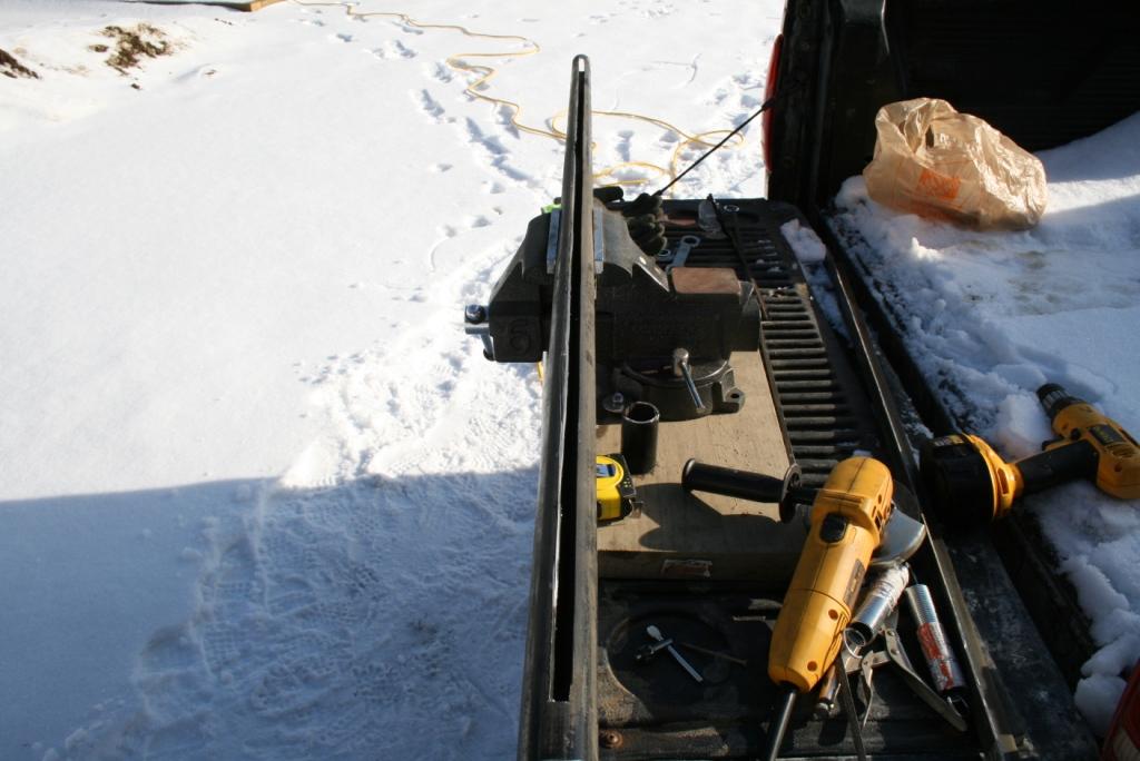

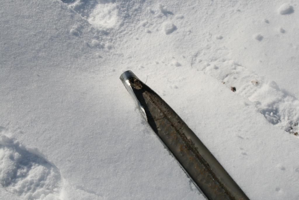

The pipe trick works well but use a thicker walled pipe. My first try, I used a piece that was too thin and it did not hold up well. I swapped it out with one that had a schedule 40 rating and that should hold up a few plowing seasons.
