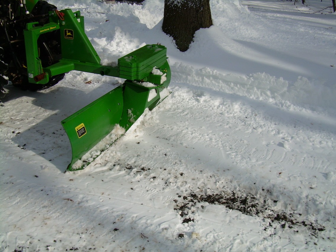

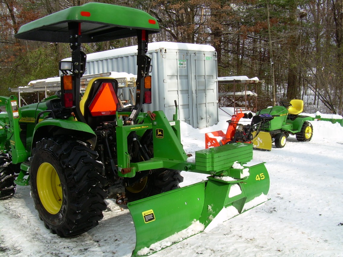

   / 3 Point Blade Over Gravel Drive In Winter #9
I have a lot of gravel drive and yard areas to clean, once it's frozen hard it's not an issue but before it freezes it is a problem, I push backwards with the plow reversed like every one suggests, I added some significant weight to prevent the blade from riding up on top of the snow, especially when the snow is deep or heavy, I do like the idea of gauge wheels like bigdad mentioned, that way you could set the blade to 1/2 inch and plow away with out tearing up your drive way, using the blade the way it was designed. after all I would be lost without the wheels on my rake.
