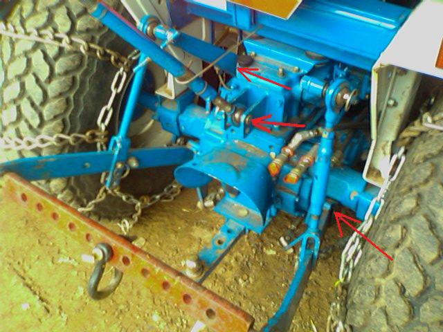

Sorry to bring an old thread to life but I checked the LSU site and understand the "standards" but the 3pt standard is to NOT lift level which is my goal. in the previous post it mentions creating a parallelogram I have attached a picture of my tractor and now need to understand what to measure to create my parallelogram... Am i to work with the lower two red arrows? which amount to where the 3pt lift arms connect to the tractor and the upper lift link? I assume the actual lift arm (top red arrow) is irrelevant? your help as usual is appreciated!!

/ 3-point attachement point dimensions.
Yes, the top arrow is not useful - but it does look pretty.
The distance I used was about 14" up from the lower lift bracket to attach my upper link arm. For my tractor (kubota 3130) it allows the 3pt to lift evenly. You will have to check with your tractor if that distance will work - probably will, but I will not guarantee it.
Dan

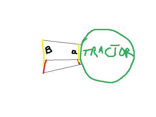

/ 3-point attachement point dimensions. #8
You need to measure the distance between your two lower red arrows...The distance between where the lower arms connect to the tractor and where the top link hooks to the tractor.
Some tractors, and it appears yours does, have different places to hook the top link up. You will need to measure to the one you will be using.
Then use that measurement when you make your attachment. The top link point of the attachment should be the same distance above your bottom link point on the attachment as the tractor.
This will make the top link parallel with the bottom link which will result in it lifting level.
Sorry for the crude diagram but the distance of A should be the same as B if you want the attachment to lift level. If B is greater than A, the tail of the implement will raise higher when 3ph is raised and vice versa

/ 3-point attachement point dimensions. #9
Thanks LD1! I thought that's what I wanted but it seems confusing when standing in the back of the tractor. Any great ideas how to measure those points as you know the lower set is under the tractor and wider then the center. I was contemplating putting a level on the 3pt arms adjust till level, put a steel square from level & measure from there up. or am I just complicating this and should just measure from the ground up? then the front to back measurement is not straightforward at all to discover.
/ 3-point attachement point dimensions. #10
I have always measured from the ground up to the top link and then the ground up to the lower arms. Subtract the lower arm measurement from the top and you got it.
The level idea would work to. It doesn't have to be exact to the thousandth of an inch. if you are a full inch off you won't notice much difference at all. Just get it as close as you can and you'll be fine
